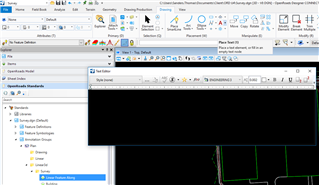

To do so, within your design file, navigate to OpenRoads Standards>Annotation Groups>Plan>Linear3d>Survey and select Annotation Group for which Invert is to be added.
Select Drawing>Place Text

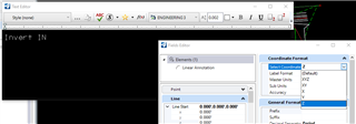

Within the Text Editor, key-in “Invert In ” a blank space should follow In.
Select Insert field  and then Select OpenRoads Plan Annotation Fields as the Filed Type and then OK.
Within the Fields Editor, navigate to Linear Annotation>Line. Because this is the Invert In, expand Line Start and left-click to the right of “Z 0.000,” Coordinate Format will open to the right. *** For Invert Out, expand Line>Line End.
Left-click to the right of Select Coordinate Z, from the dropdown menu select Z and then OK.

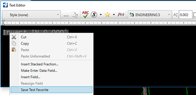

Select the Invert In 0.000’ from Text Editor (make sure that it is highlighted), right-click in the Text Editor and then select Save Text Favorite from the menu (you will see the newly saved Favorite listed). Close Text Editor.
