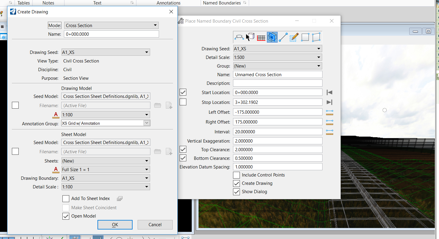

No view found for cross section boundary
  Product(s):OpenRoads Designer
Version(s):10.00.00.120+
AreaCross Sections
Original Author:Purva Lakde. Product Advantage Group
Question:
Created Named Boundary for the Cross Section Group but once click "Create Drawing", the error prompted. No view found for cross section boundary. How to create cross section drawing?
Answer : Turn ON one more windows with Default-3D model. Then you can create drawings for cross sections as it's mandatory to toggle ON 3D model in Open Roads Designer.
