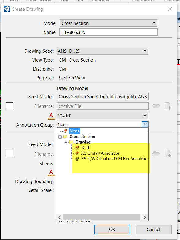

OpenRoads Designer: How to set grid for the Cross Sections on the drawings and the sheets?
  Product(s):OpenRoads Designer
Version(s):10.00.00.120+
Area:Cross Sections
Original Author:Purva Lakde. Product Advantage Group
Question:
Answer:
When "Create Drawing" dialog box produce for the cross sections, there need to select Grid or XS Grid w/Annotation under "Annotation Group".
