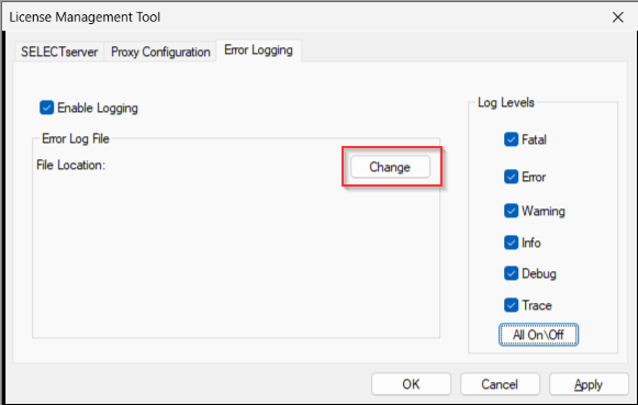

1) Open the [[License Management Tool]] included with your Bentley product(s).
2) Select Options from the Tools menu.
3) Click the Error Logging tab in the window that appears.
4) Tick the checkbox labeled Enable Logging.

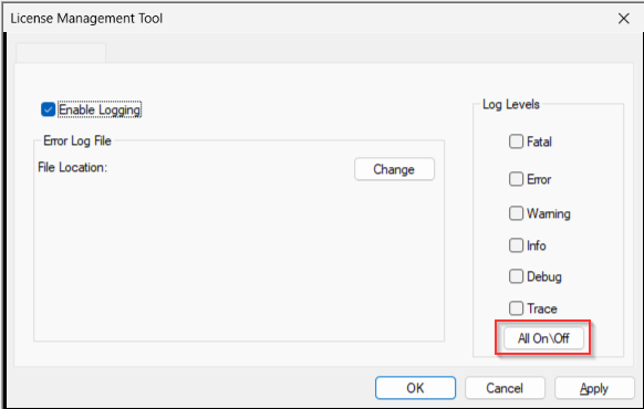

5) Click the All On\Off button in the Log Levels section to capture all diagnostic data.
6) Click the Change button in the Error Log File section and specify a location to save the log file.
7) Click the Apply button at the bottom to save changes.

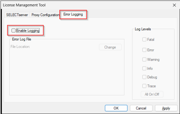

8) Reproduce the licensing problem to capture all interactions between the client computer and the SELECTserver. Then return to the License Management Tool.
9) Untick the checkbox labeled Enable Logging.
10) Click the OK button to save changes and close the dialog.
