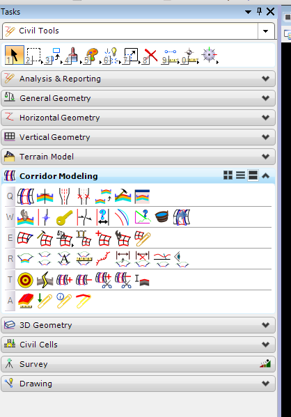

Where are the Cross Section and Modeler commands in SS3/SS4/SS10?
Some Cross Section tools and all of the Modeler Tools are now part of our new OpenRoads Technology.  These commands are located in the MicroStation Corridor Modeling Tasks menu.
Not only have the cross section and modeler tools been relocated to the Tasks menu, the workflow for Roadway Design, as well as creating/editing cross sections, has been changed and improved to incorporate OpenRoads Technology. For more information on OpenRoads Technology, please visit our OpenRoads wiki page.
