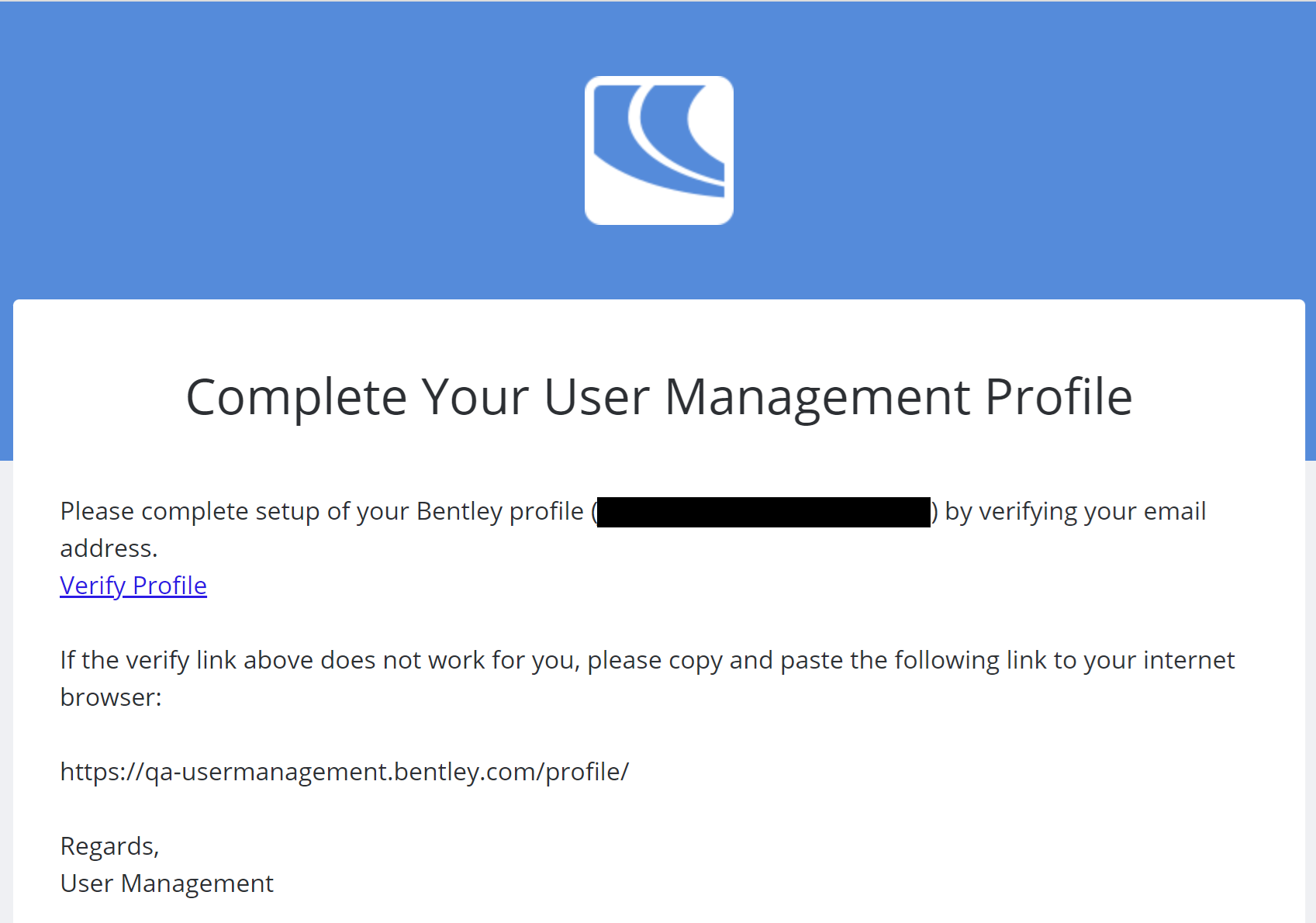

When an administrator adds users individually or in bulk via the User Management portal, end users will receive an email titled "Complete your Bentley Systems profile" like the example below:
Screenshot of user profile completion email
Users can click the "Verify Profile" link in the email to complete the registration process by creating a password. Alternatively, users can complete the process by navigating to https://ims.bentley.com. In either case, end users should perform the following steps:

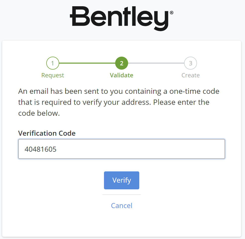

  3. A verification code will be sent to the email for security with an email subject of "Verification Code from Bentley" as shown below:
    Screenshot of verification code email
  4. Enter the verification code from the email on the web page, and click the Verify button:

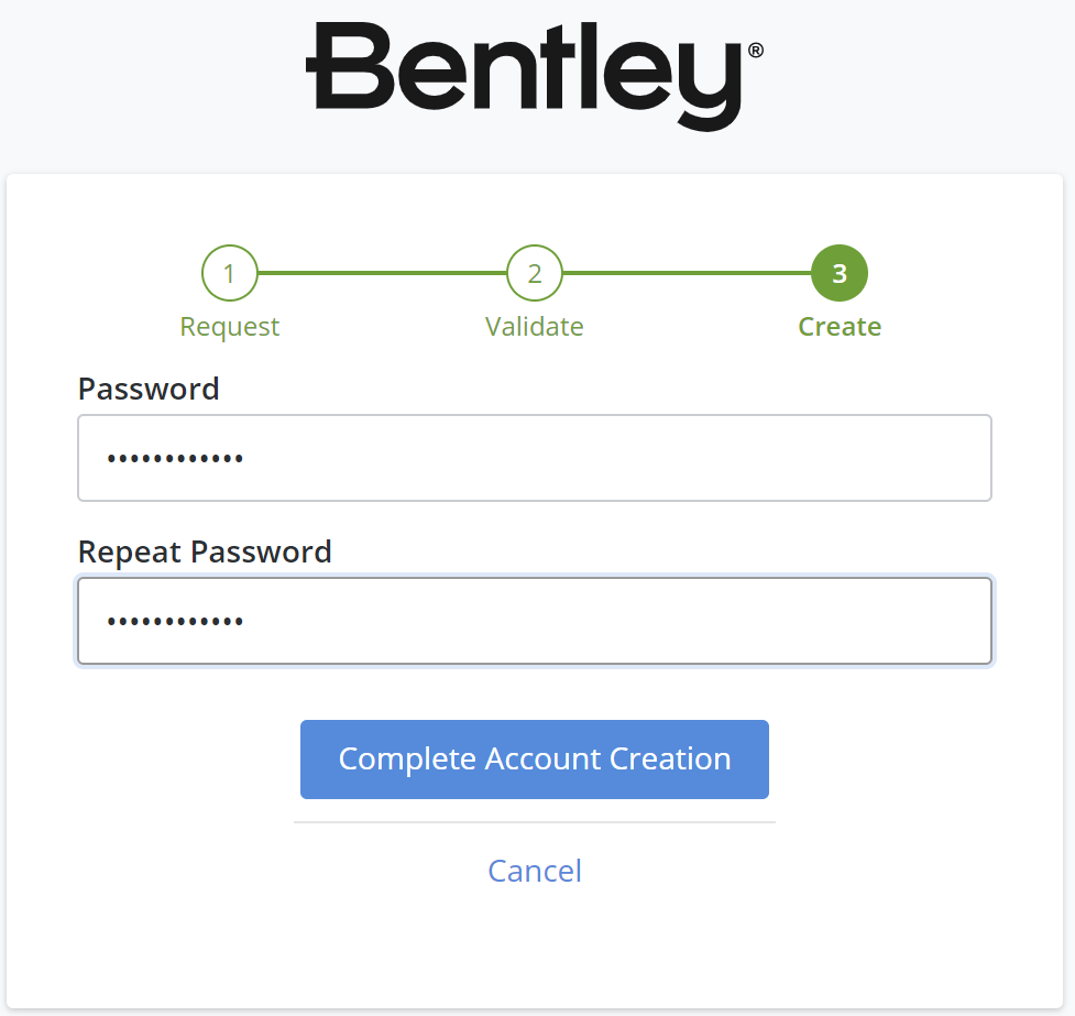

  5. Create a new password, and click the Complete Account Registration button:
    Screenshot of create step in user registration process

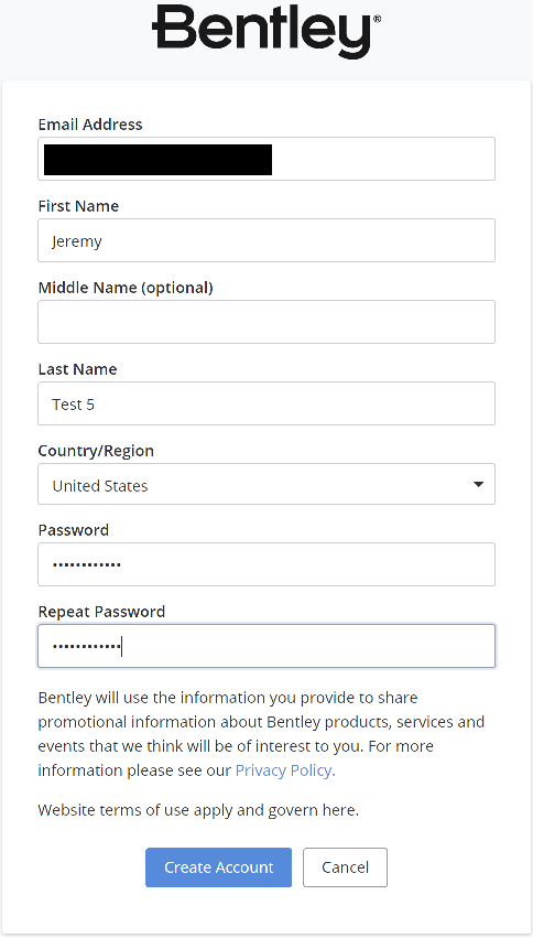

  2. Complete the form presented:
    Screenshot of user registration form

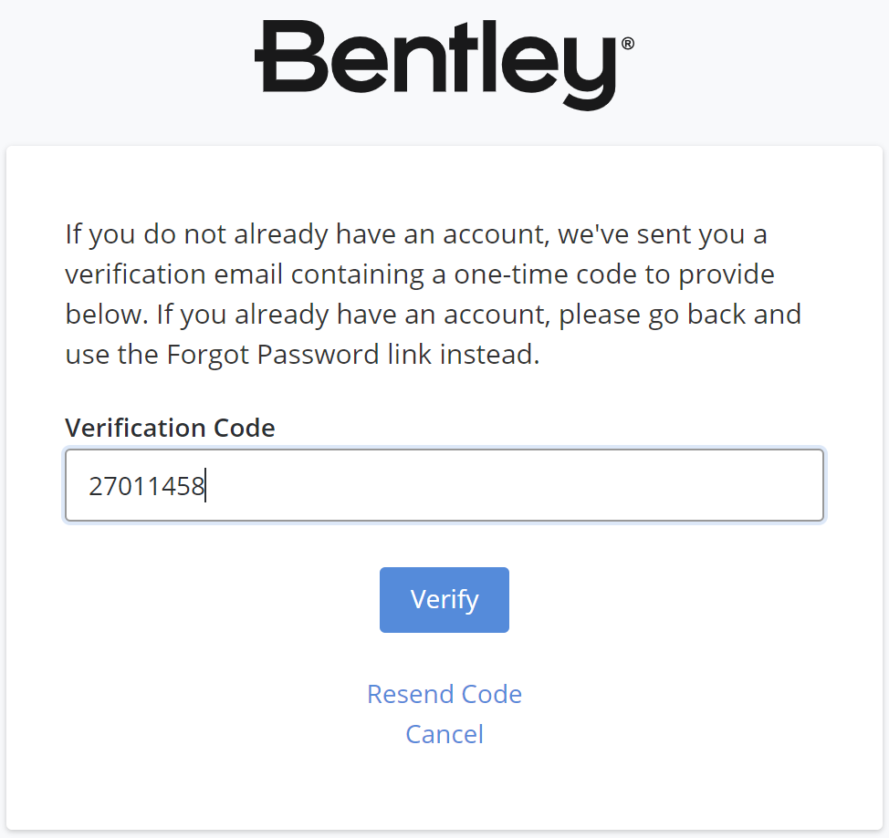

  3. For security, an email will be sent to the email address with a verification code:
  4. Copy and paste this code on the Verification Code page that appears on the web page, and click the Verify button.
    Screenshot of verification code step in user registration process

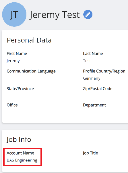

InformationImportant: If registering yourself with an email domain that has not been claimed by your administrator, you may initially have no access to licenses until an administrator associates you. To check, navigate to https://ims.bentley.com, sign in with your new IMS login, and note on the profile page that appears whether the Account Name attribute is populated as shown below. If blank, contact your administrator for further assistance.
Screenshot of IMS profile page with Account Name highlighted
