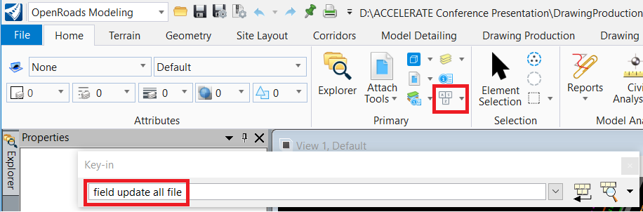

This video demonstrates how to update Title Block Annotation that was pulled from WorkSet properties using a key-in.
You've created your Drawings, but then you have made edits to the WorkSet Properties. These properties are used as annotation in the title block of every single Sheet model in your dgns. You are noticing that you will have to open each dgn/model to for the annotation to update. How can this be done quicker? Watch the video below... A sneak peak is if you need to update models, use the "field update all file" key-in. If you need to update dgns, use File > Tools > Batch Process to run this same key-in on multiple dgns at once.
