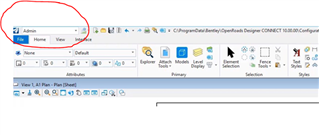

How to show Admin is in the customize tool box in the pulldown on the top left ?
Answer:
Two Methods:

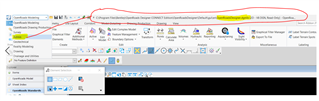

1. You would need to add the DGNLIB into the variable MS_GUIDGNLIBLIST and then open the DGNLIB directly. Please refer attached the snapshots for your reference.
Location: C:\Program Files\Bentley\OpenRoads Designer CONNECT Edition\OpenRoadsDesigner\Default\gui\en
