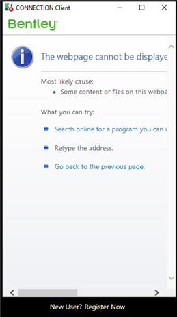

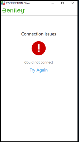

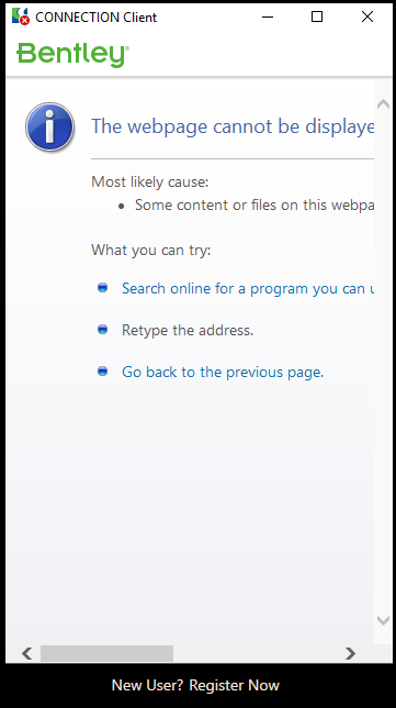

1. Enter Email and Password then click Sign In in the CONNECTION Client
2. You are presented with either of the following errors:
"The webpage cannot be displayed..."
Or "Connection Issues. Could not connect..."
There are several reasons that your CONNECTION Client fails to sign in. Here are a couple of known reasons.
Temporary Interruption
As a first step, try right clicking in the middle of the CONNECTION Client window and choose "Back". Or, press F5 to refresh.

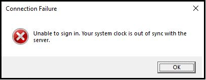

System Clock
Error : Unable to sign in. Your system clock is out of sync with the server.
When you sign in to the CONNECTION Client you receive a security token that is time stamped. If your clock is incorrect you have to fix it before you can sign in. In the error above it references that your system clock is not in sync with the server. The server mentioned in your network server. In that case you'll need to contact your IT department to request that the time on the server is fixed.
The error may not present, but you'll see the following in the logs:
DEBUG - LoginControlViewModel - Failed to deserialize token: System.IdentityModel.Tokens.SecurityTokenNotYetValidException: ID4222: The SamlSecurityToken is rejected because the SamlAssertion.NotBefore condition is not satisfied.
NotBefore: '4/27/2021 1:46:19 PM'
Current time: '4/27/2021 12:51:19 PM'
To resolve the issue, synchronize the clock on your local Windows machine with the time server at https://www.time.gov , alternatively, manually set the time with the time displayed on https://time.is. Then, restart CONNECTION Client, and attempt to sign in again.
Once the clock is corrected you should be able to sign in successfully.
