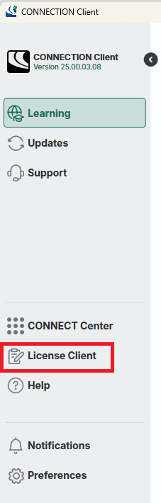

Option 1 - from CONNECTION Client
Using the 'License Client' item in the CONNECTION Client left navigation menu:

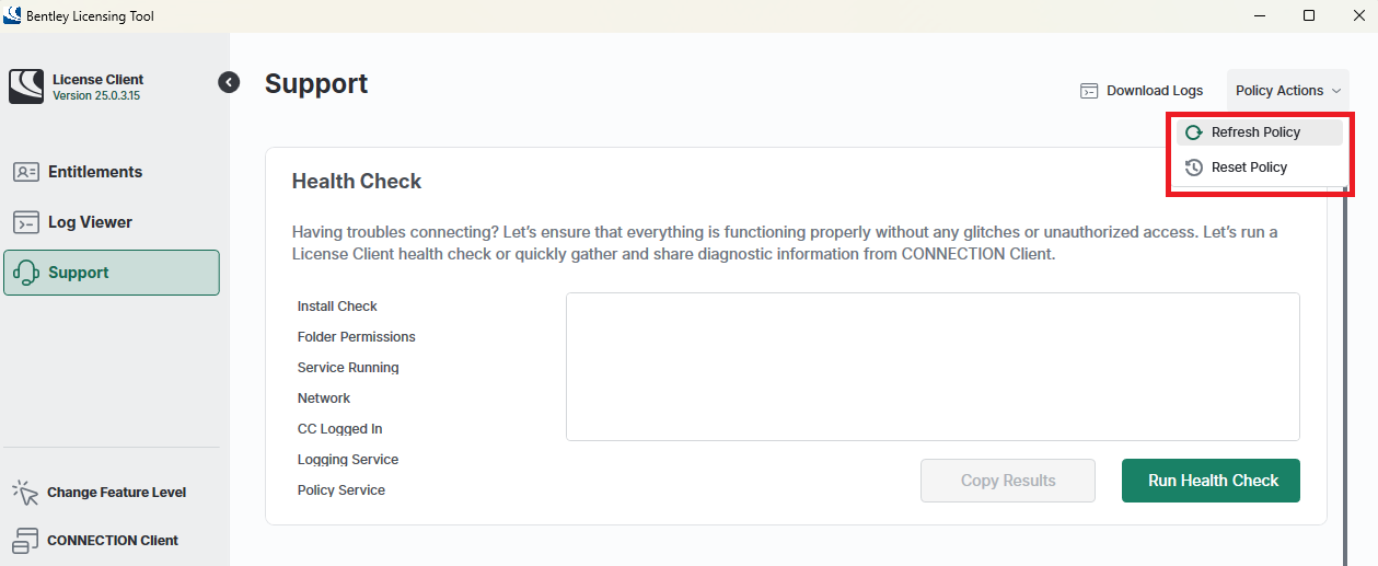

2. Refresh the Policy
       Refresh Policy and Reset Policy are available from the Support menu.
Refresh allows the user to manually request a refresh of product entitlements, either because they have expired or have changed due to administrator changes.  This is typically not necessary as entitlements are refreshed automatically every 4 hours. Refresh does require that a user be signed in to the CONNECTION Client.

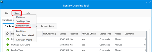

Process the following: TOOLS > Send Logs Now and then TOOLS > Refresh Policy
Screenshot of Refresh Policy option in Bentley Licensing Tool
