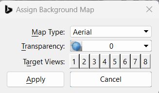

Assign a Geographic Coordinate System first and then access and assign Bing map imagery in the background view of your DGN as follows:
  1. Utilities Tab
The Assign Background Map tool available in the ribbon allows you to easily apply the map settings to multiple views.
A screenshot of a computerDescription automatically generated A screenshot of a mapDescription automatically generated

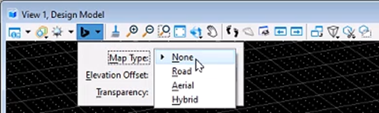

  1. View Control Bar
OpenRoads Designer 10.02.00 to 10.12
For versions prior to OpenRoads Designer 2023, the Background Map displays in the View Attributes dialog after attaching the Geographic Coordinate System (GCS).
There are 3 requirements necessary to display the Bing background map:
1.) Internet Connection
2.) Coordinate System defined in the DGN file
3.) Logged into the CONNECTION client.
