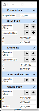

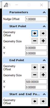

After selecting the geometry to edit a dialogue box will appear with settings that can be edited as desired.
For instance after selecting a tangent single element the dialogue will appear as shown below. Start and end points can be shifted/nudged by offset values set in the nudge offset field. Also the entire geometry can be shifted in the Start and End Point> Geometry Offset field.
Arc elements, for example, will give the user access to Center Point fields where the radius and coordinates specific to the arc can be manipulated
