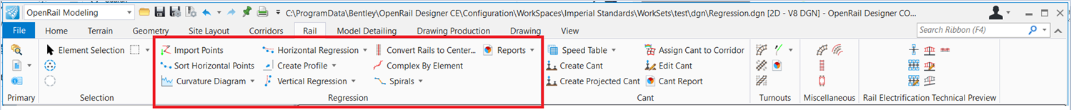

The Regression tools are located within OpenRail Designer at OpenRail Modeling > Rail > Regression as shown below:
