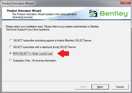

Once in the Product Activation Wizard, you are given the following options:
You will want to verify that NON-SELECT or Node locked user is selected.
Once selected, click Next> in the bottom right corner.

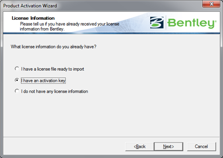

On the next screen, you will be asked about your "License Information."  You are given the following options:
Typically you will have an activation key to activate with. This is sent through fulfillment documentation once the perpetual license is created.

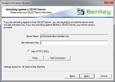

When selecting the "NON-SELECT or Node locked user," the server name will be filled in by default.
Fill in the Site Activation Key in the Site Activation Key box. Due to the length of the site activation key, it is recommended that each user copy and paste the information directly into the license management tool.  Also, be sure there are no extra spaces before or after the server name and site activation key as this can prevent a proper activation.
Once completed, click Next> in the bottom right corner.

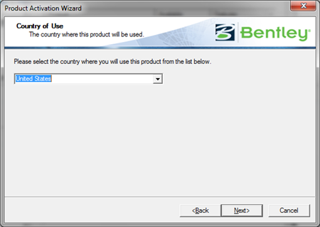

Depending on what version of software in being installed, the country where the product will be in use may have to be selected.
Once a "Country of Use" is selected, click Next> in the bottom right corner.

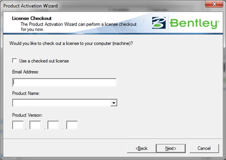

On the next screen, you are prompted with a "License Checkout" dialog.  As a NON-SELECT user, you must use a checked out license.
The box next to "Use a checked out license," should be checked by default, but if it is not, be sure to do so.  Fill out all fields on the License Checkout screen
*** Please note: It is important to enter the correct version number of the product being activated.
Some versions of the License Management Tool require that you enter 3 digits for each field of the version number instead of 2. If you cannot proceed to the next step of the product activation, try adding a leading zero to the values in the version boxes (for instance, 08 becomes 008).
The version number can be found by opening the product, clicking the Help menu and selecting "About <Product>".
*** Please note on some versions of the License Management Tool that you may get a message stating "The requested operation failed'. This is a non-fatal timeout error. Please allow the software 20 seconds to complete its activation.

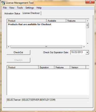

  1. Start the License Management Tool.
  2. Make sure that you are on the License Checkout Screen.  Some older versions default to this screen, newer versions will need to click on the Tab.
  3. Go to File>Import.
  4. Navigate to an XML license file, and click Open. If successful, a dialog should state that the license import succeeded.
  5. Close the License Management Tool by selecting “Exit” from the “File” menu. If the product(s) are currently running, you will need to restart them in order for your new license(s) to take effect
