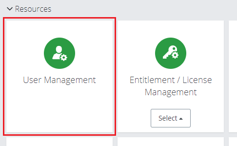

Accessing User Management
To access User Management, perform the following steps:
  1. Navigate to the Subscription Services Portal.
  2. Scroll down the the Resources section.
  3. Click on the User Management file.
    Screenshot of User Management tile

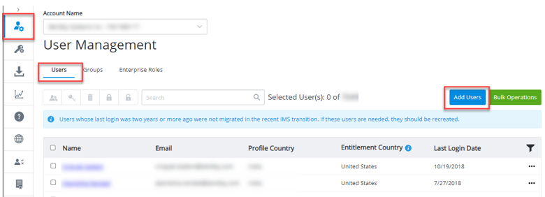

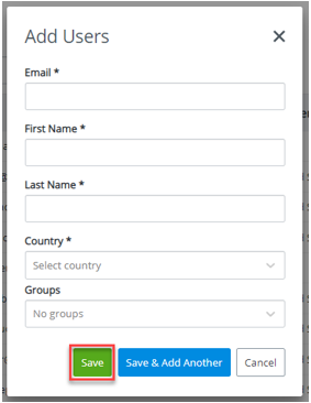

If you are a Administrator or Co-Administrator you can add users within User Management using the following steps:
1. On the Users and Groups screen, click Users tab and then click the Add Users button in the upper right corner.
2. Complete the fields and click the Save button.
Note: If you are told the user already exists and are not given an option to add to the account, the user is tied to a different account and must be removed first. For more information, see: Unable to add users - user already exist within another ultimate

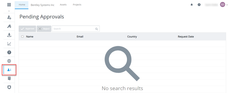

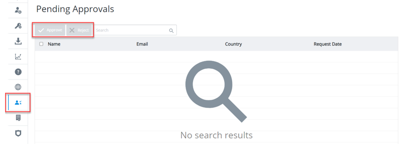

User Approvals
1. From the User Management screen click the Pending Approvals icon to display the users waiting to be approved.
2. To approve/reject users from the list select one or more users in the list and click Approve or Reject.

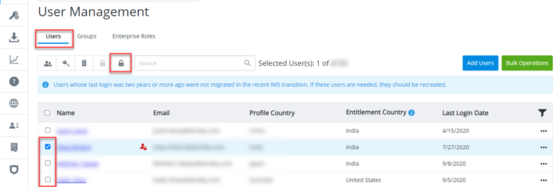

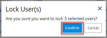

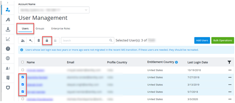

Lock and Unlock Users
Locking an IMS account does not automatically stop entitlement access/usage reporting. Locking the user will only block the access to login ID and password but if user has previously logged in then they get 7 days Disable mode access to the product. Users should be deleted from your organizations User Management, which will unaffiliate them from your account or the user should be Denied access via an exception in Entitlement Management.
To delete, see next topic Delete Users
For Exceptions, see https://bentleysystems.service-now.com/community?id=kb_article_view&sysparm_article=KB0019345
Federated accounts - Locking a user from User Management does not lock the users account, management of users is done directly via your Active Directory
1. On the User Management screen, click Users tab, select user(s) and click Lock User(s) icon on the screen above user list to disable login for the selected user(s).
2. Click the Confirm button to lock the selected user(s).
3. Click Unlock Users icon on the screen above user list to enable login for the selected locked user(s).

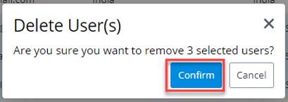

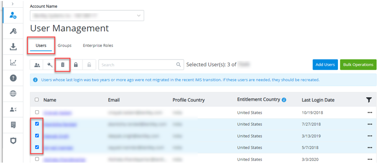

Delete Users
NOTES:
- Removing user's roles prior to deleting is recommended, see: Managing Roles
- If a user you want to remove is designated as a fulfilment contact, you need to remove that user from fulfilment contacts first. Otherwise, you will receive an error when attempting to remove such a user. Also, note that there must be at least one Global fulfilment contact designated for the account. See: Managing Fulfillment Contacts
- If a user you want to remove is assigned a Practitioner License, make sure to re-assign the license prior to removing the user in User Management. If you remove an assigned user, Practitioner License will show "User Not Found", and you will not be able to re-assign it. If this is the case, please open a service request, choose "Licensing and User Administration" for the category and in the description include details about the removed user.
1. On the User Management screen, click Users tab, select user(s) and click Delete Users icon on the screen above user list.
2. Click the Confirm button to delete the selected users.

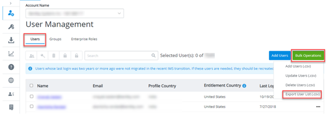

Export User List
  1. On the User Management screen, click Users tab, click Bulk Operations button and click Export User List.
2. Save the .csv file which can be opened in Excel to see the list
