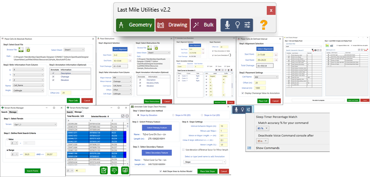

What are LastMileUtilities?
LastMileUtilities Download Links
MDL App
Help Document
Version
Release Date
Release Notes
Download
Read Me
2.2
10-Jun-2026
  • Fixed the limitation of 50 meters for creating Slope Annotation
  • Fixed bugs related to Excel files in the Place Obstructions & Absolute XYZ tool
  • Removed dependency on external DTMEditor DLL. Now DTM editing is part of the standard OpenRoads Library
  • Updated .NET Framework to 4.8
  • Added more accuracy % values in Voice Commands
  • Updated links to all VIDEOs from the Help Menu
Download
Read Me
2.1
1-Jul-2021
  • Digital Signature for Lastmile Utilities App to align with Security policies
  • New Tools:
    • Bulk Operation > Level Display Manager for applying the Level Display settings from the Current DGN to all selected DGN
    • Drawings > Side Slope Annotation for annotating slope lines between 2 selected features/lines (2D or 3D) with customizable placement options (tech preview)
  • Improvements
    • Voice Command Feature: Support for OpenSite Designer default Command list
    • Annotate Curve: Option to add a new parameter for Curve:  HPI (Horizontal Point of Intersection)
  • Bug Fixes:
    • The toolbar closes after every DGN switch within the tool
    • Minor bug fixes
Retired
Read Me
2.0
23-Apr-2021
  • Improved toolbar UI
  • Added Voice Command Console for quick actions
  • New Tools added, like 'Terrain Points Manager' and 'DGN Models Exporter'
  • Improvements in the tool 'Annotate Curve Parameters'
  • Bug Fixes & other enhancements, including updated documentation
  • Integrated Video repository for all tools
Retired
Read Me
1.1
12-Feb-2021
  • Improved way to mention parameters for Curve Annotation
Retired
 Read Me
1.0
19-Jan-2021
  • Place Cells at Absolute Position
  • Place Cells at Defined Interval
  • Place Obstructions
  • Annotate Curve
How to Install LastMileUtilities App & Use?
Tool Key-in
Sr. No. Tool Description
Key In command
1 LastMile Open Opens Last Mile Utilities toolbar LM Open
2 LastMile Close Closes Last Mile Utilities toolbar LM Close
3 LastMile Help Shows Help for Last Mile utilities toolbar LM Help
4 Place Obstructions Place Cells using an alignment using obstuctions data mentioned in the Excel file LM Place Cells_From_Excel
5 Place Cells at Defined Intervals Place Cells at a defined interval along with an alignment Location LM Place Cells_At_Interval
6 Place Cells At Absolute Position Place Cells at Absolute Location using the data mentioned in the Excel file LM Place Cells_At_Absolute_Position
7 Annotate Curve Parameters Annotate Curve Parameters LM Annotate Curve
8 Terrain Points Manager Update Terrain Point(X, Y, or Z), Exports Terrain Points report LM Show Terrain_Points_Manager
9 DGN Models Exporter Group All CrossSections ina  Single DGN, Split All Sheets Into Individual DGN, or Split DGN Libraries LM Show DGN_Model_Exporter
10 VoiceCommand Start Starts Voice Command Console LM VoiceCommand Start
11 VoiceCommand Stop Stops Voice Command Console LM VoiceCommand Stop
12 VoiceCommand List Shows a list of voice commands and allows the user to add, edit, or delete commands
LM VoiceCommand List
13 Level Display Manager Apply the Level Display settings from the Current DGN to all selected DGN
LM Show Level_Display_Manager
14 Side Slope Annotation Annotate slope lines between 2 selected features/lines (2D or 3D) with customizable placement options (tech preview) LM Annotate Slope
