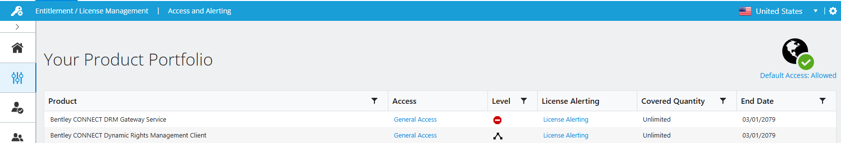

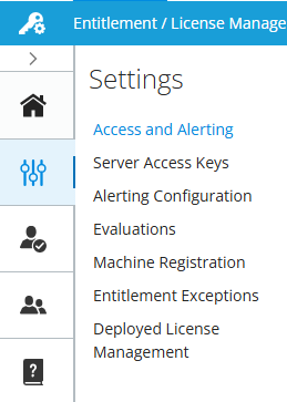

To configure License Alerting for individual product, navigate to the Settings in the left navigation menu and go to Access and Alerting.
Find the product whose alerting you would like to configure in the list. Click on the License Alerting link underneath the Modify Alerting header to open the License Alerting page for that product.

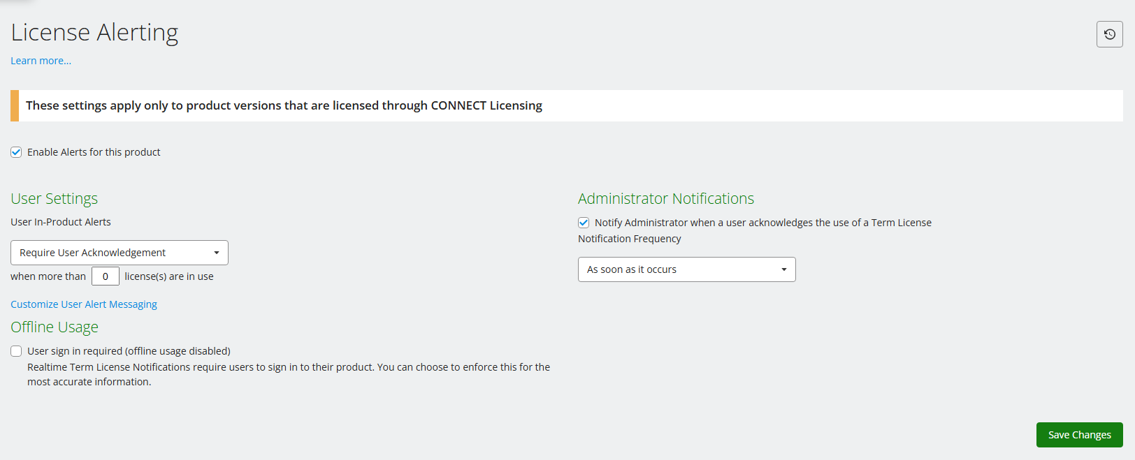

On the License Alerting page, click the 'Enable Alerts for this product' checkbox. This will open additional settings. Click the 'Save changes' button to save your configuration.
User Settings
Option Definition
when more than x license(s) are in use Configures the number of licenses that may be in use before an alert will be issued. Ex., if this is set to 5, and five licenses are in use, any new user that tries to open the product will receive an alert.

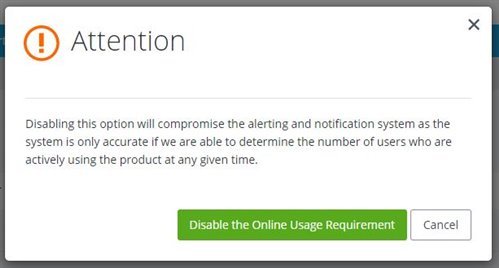

User sign in required
If this is checked, then users must have an internet connection* and be signed into the Connection Clients to use Bentley products.
If this is not checked, users will be able to use Bentley products offline which may result in the license threshold being exceeded.
*If User sign in is required, users that do not have an internet connection will not be able to start their Bentley products. Even if an admin unchecks this box, they will still not be able to start the product until the machine has connected to the internet to get the new policy. In this scenario, the only way for an offline user to start their Bentley product is if an admin creates a checkout and walks the policy file over to the user's machine.

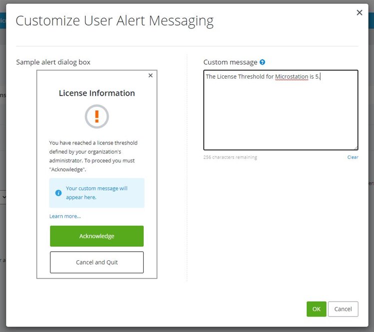

When a user receives an alert, it has a default message indicating that the license threshold has been reached. You may use the Customize User Alert Messaging link to create an additional custom message. For example, you may indicate the license threshold or suggest a person at your organization to contact.
Administrator Notifications
These settings apply to all Admins and Co-Admins.
Click the 'Notify Administrator when a user acknowledges the use of a Term License' checkbox to enable Administrator Notifications for when the alert threshold has been reached..

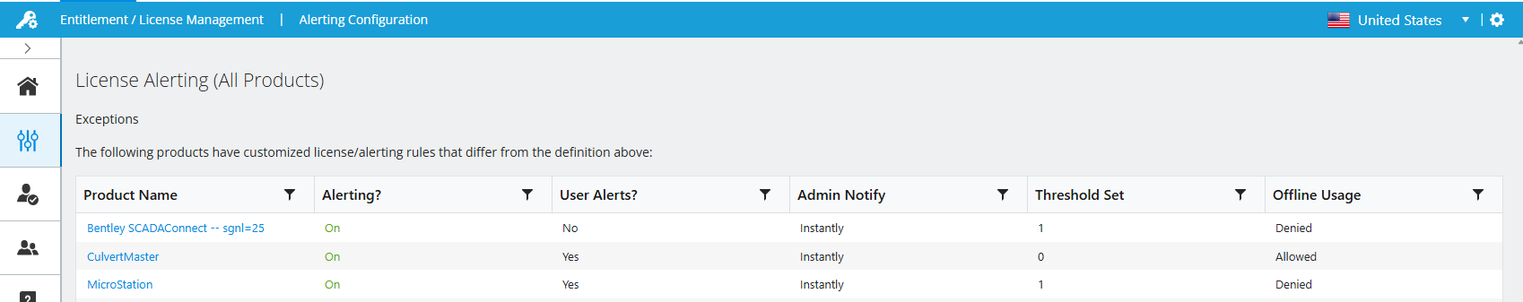

All Products
Navigate to the Settings in left pane and go to Alerting Configuration .

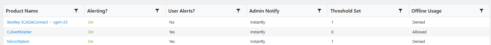

The Exceptions table lists all of the products that have had alerting configured. You may quickly identify and change these by clicking on the hyperlinked Product Name.
