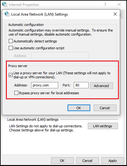

What if my organization has a proxy server? Where do I enter the server address, user name, and password?

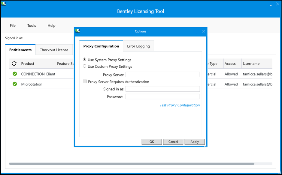

Proxy information is read from the Bentley Licensing Tool. The Bentley Licensing Tool is found in "C:\Program Files\Common Files\Bentley Shared\CONNECTION Client\LicService\Bentley.Licensing.LicenseTool.exe". You can also do a search for Bentley Licensing Tool in the Windows Start menu. In the Bentley Licensing Tool go to Tools > Options > Proxy Configuration tab. CONNECTION Client 10.00.18.13 and later supports the use of system proxy settings as configured in the Internet Options control panel like the example below:
For most users, ensure "Use System Proxy Settings" is selected as shown in the screenshot below. To manually configure proxy settings, select the "Use Custom Proxy Settings" radio button instead. Then enter a proxy server name in the Proxy Server field. If communicating on a port other than 80, add a colon and the port number following the name. For example, if the proxy was named proxy.company.com with a port of 8080, the Proxy Server field would be populated with the following value:
proxy.company.com:8080
If a user name and password are required toggle on the "Proxy server requires authentication" box and enter the user name and password.
Click the Test Proxy Configuration link that appear in the lower right corner after entering proxy settings to ensure they are valid.

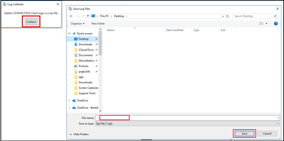

Where do I find the CONNECTION Client logs folder?
Typically when having an issue with the CONNECTION Client you're asked to zip the entire Logs folder and send it in to support. It's located at C:\Users\User Name\AppData\Local\Bentley\Logs or use this shortcut in the browser address bar %localappdata%\Bentley\Logs.
In CONNECTION Client version 10.00.13.17 and newer there's a Bentley Log Collector that will gather all of the logs that support needs to begin troubleshooting a CONNECTION Client or Subscription Entitlement Service issue.
Type Bentley Log Collector in the Windows search field to locate it, or go to "C:\Program Files\Common Files\Bentley Shared\CONNECTION Client\LogCollector.exe"
Simply click the Collect button > Browse to a folder > Name the file > Click Save >  a zip file is created with all of the log files support requests.
