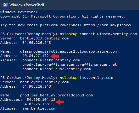

  1. Right-click on the Windows Start menu, and select Windows PowerShell from the contextual menu.
  2. Execute the following two commands:
    nslookup connect-ulastm.bentley.com
    nslookup ims.bentley.com
  3. The first command will give an IP address for the Microsoft Azure data center in use by the majority of our services. The second command will give an IP address for the Amazon Web Services (AWS) data center in use for some of our services.
Screenshot of nslookup output

  1. Download the latest Microsoft Azure IP address ranges.
  2. Open it, and search for the first two octets of the IP addresses found with the "nslookup connect-ulastm.bentley.com" command. For example, the screenshot above gives an IP address of 40.84.27.172 which would require a search for 40.84. Search results will be found in specific service tags which give several ranges of IP addresses. Add these ranges to your firewall.
  3. Download the latest AWS IP address ranges.
  4. Open it, and search for the first two octets of the IP addresses found with the "nslookup ims.bentley.com" command. For example, the screenshot above gives an IP address of 54.82.25.138 for one of the addresses which would require a search for 54.82. Search results will be found in specific service tags which give several ranges of IP addresses. Add these ranges to your firewall.
