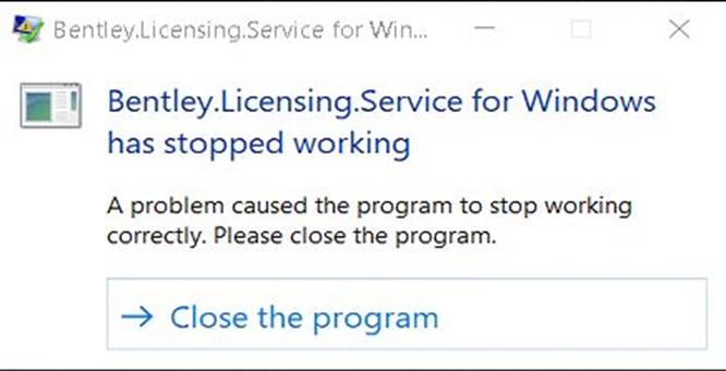

The "Bentley.Licensing.Service For Windows has stopped working" Error
Possible Cause
Local users that are not Administrators on their system get an Administrator to do the CONNECTION Client initial install or CONNECTION Client upgrades under their Administrator login.
An elevated instance of Bentley.Licensing.Service.exe from an administrator account (left over from the CONNECTION Client install) can intercept licensing traffic, preventing the end user's own Bentley Licensing Service (running under their user profile) from working correctly.

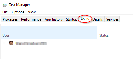

Click on the "Users" tab, and note whether anyone other than the user is signed in, especially if the account is for an administrator. If so, log this user off.

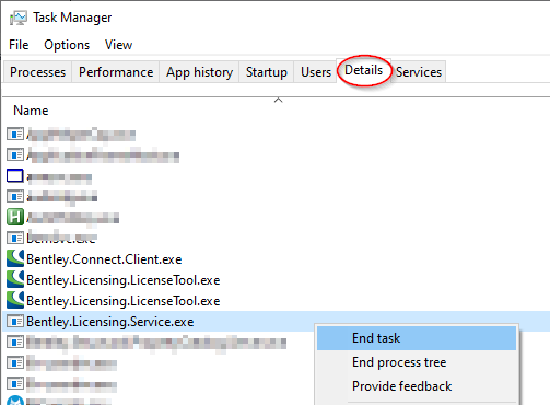

Otherwise, go to the Details tab, and note whether any instances of Bentley.Licensing.Service.exe are running as someone other than the user. If so, right click on the task and choose end the task for the other user if possible.
