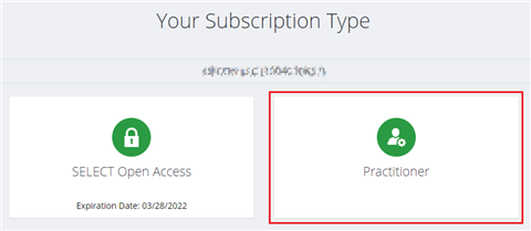

  2. Click the Virtuoso tile (Main page - Your Subscription Type). If not showing, pull down the country drop-down menu along the top, and select Global.

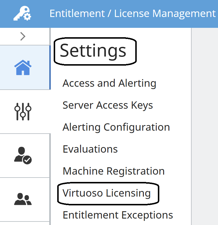

    Alternatively, you can access the Virtuoso License from the side navigation - Settings > Virtuoso Licensing.

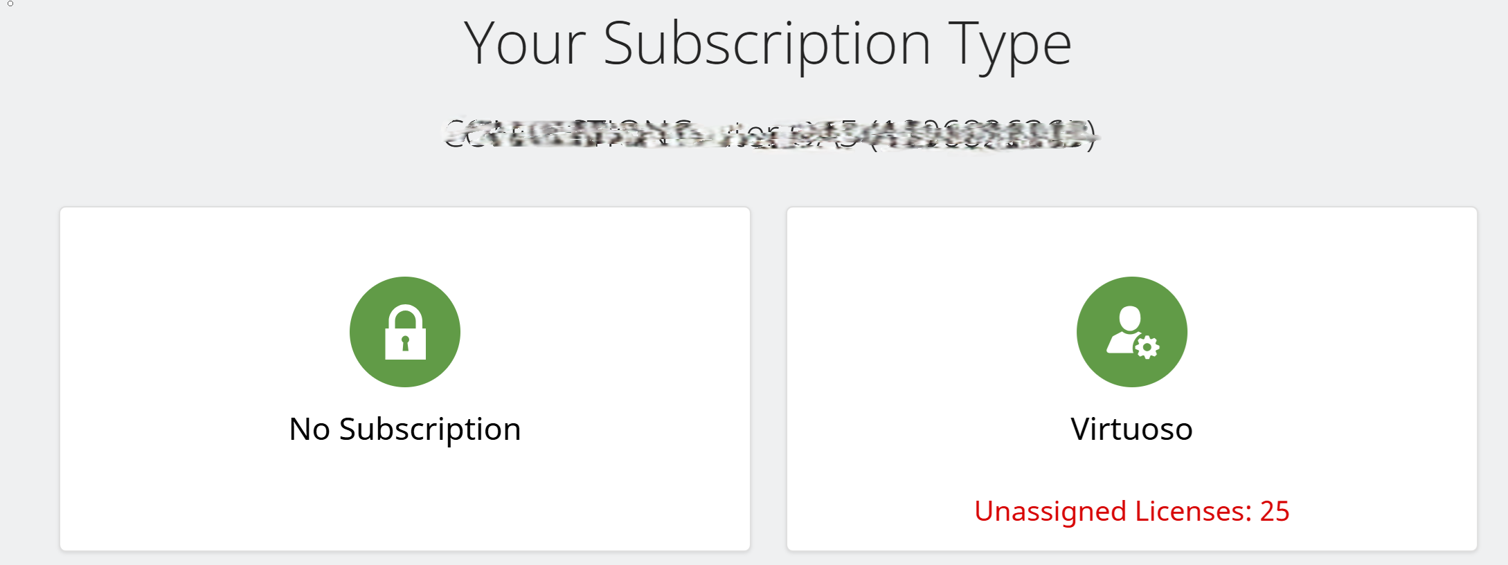

Virtuoso Licenses that are not assigned will not be used in any entitlement requests by the organization’s users or the subsequent billing of the usage generated while the Virtuoso License is unassigned. To make full use of the Virtuoso License for its duration, the license must be assigned to a user.
Reminders will be displayed to administrators in the Subscription Services Portal and Entitlement Management if any Virtuoso Licenses are unassigned.

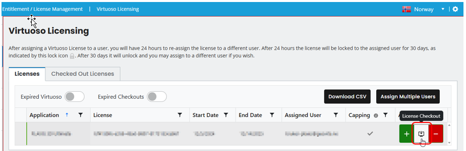

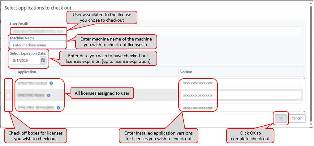

Can I check out a Virtuoso License?

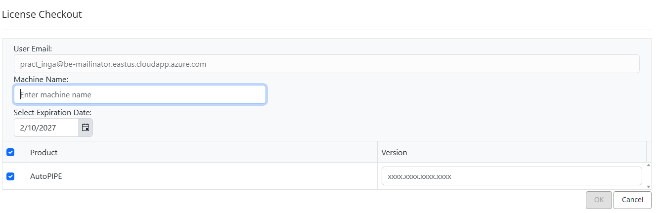

Yes, check-outs are available for Virtuoso Licenses. User needs to connect to the Internet at least once to check out the license in Bentley Licensing Tool. For steps, see: Bentley Licensing Tool: Checkout License Tab
Checkouts from Manage.Bentley.Com Portal
1) Select "Products" and click on The product you wish to check out a licenses for -
2) Pick which license you wish to assign, check off the box to the left of the license.
3) Locate the "Actions" dropdown and choose "Check out license"
4) Fill in the "Machine name" and "Expiration date" fields on the popup, and click "Check out"
Checkouts from From Admin Portal -
Click License Checkout Button
Fill in the blanks and click OK -
