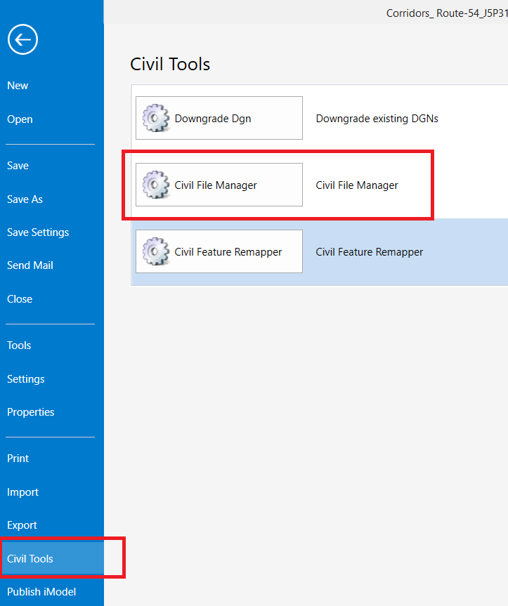

This video demonstrates the use of the new Civil File Manager utility added with the 10.09 update. This utility replaced the Version Checker, and a new downgrade feature was added. To learn more about downgrading, click here.
To access the tool, go to File>Civil Tools>Civil File Manager:
To upgrade files using the Civil File Manager:
1. Pick File>Open and select the folder and/or files to upgrade.
2. Pick View>Upgrade List.
3. Pick Action>Upgrade All or Upgrade All (Force)
