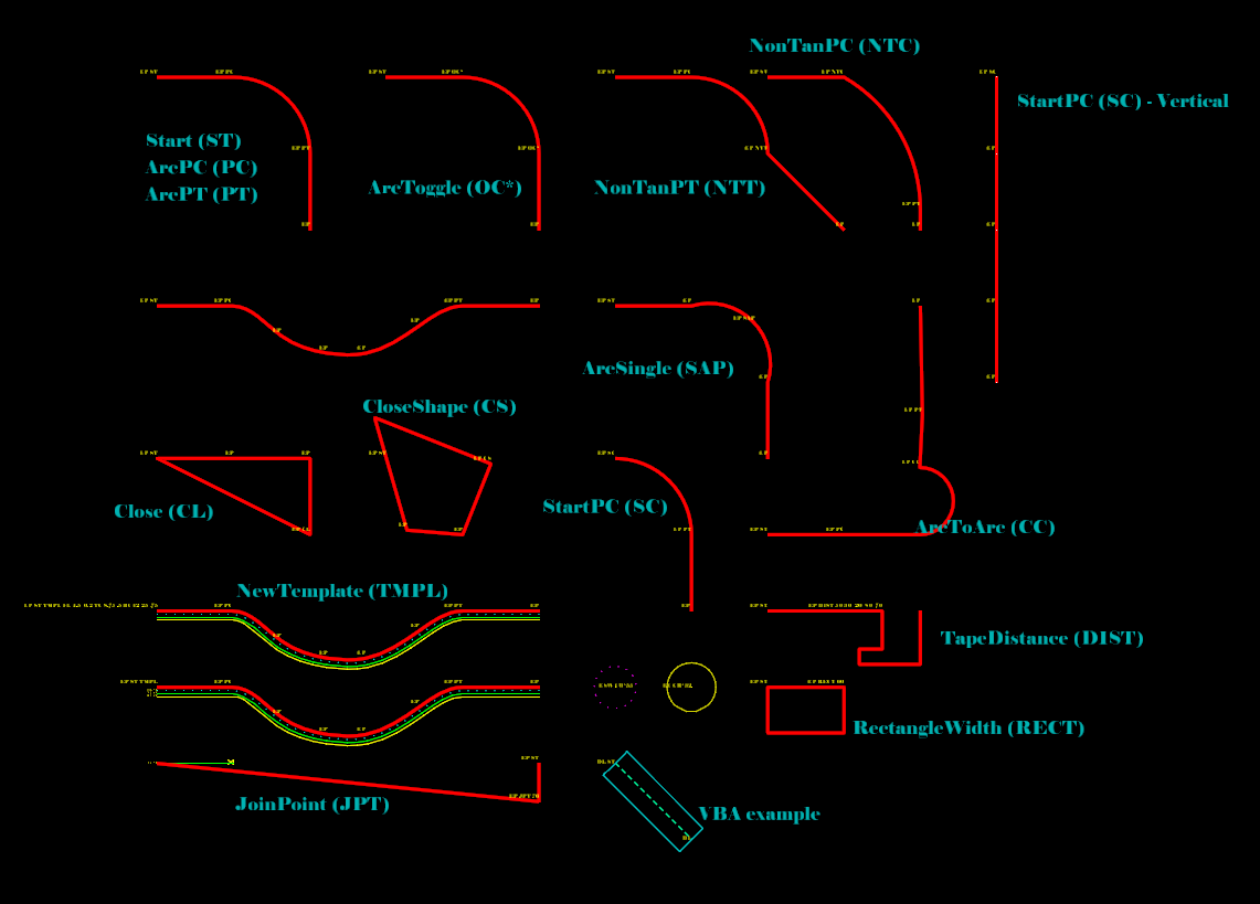

Can you provide an example of the linking codes available in OpenRoads Survey?
Answer:
 Point Coding example files
The link above contains zip file that has an example DGN/CSV file that demonstrates each of the linking codes available in OpenRoads Survey.  Contents include:
Below is a clip from the Help file explaining the various linking/control codes:
Linking Codes
Start
begins creating a Linear Feature
StartPC
starts a linear feature in Arc Mode
ArcPC
specifies the beginning of a tangential arc or curve within a Linear Feature
NonTanPC
specifies the beginning of a non-tangential arc or curve within a Linear Feature
ArcSingle
creates a three point arc with previous and next points (does not work at beginning or end of a Linear Feature)
ArcToArc
ends previous tangent arc and begins another tangent arc (must be preceded by ArcPC)
NonTanPT
specifies the end of a non-tangential arc or curve within a Linear Feature
ArcPT
specifies the end of a tangential arc or curve within a Linear Feature
ArcToggle
toggles between NonTanPC and NonTanPT (depends on pairing)
End
ends the linear feature (not necessary in most cases)
CloseShape
closes the ends of the linear feature by adding right angle at both ends and intersecting
Close
closes the Linear Feature back to the first point
