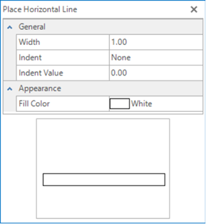

Horizontal Line - A horizontal line that automatically extends the width of the panel relative to the panel size with either no indent, indent to radius or indent a specific value. Unless overridden, the horizontal line width is the same as the panel border width.

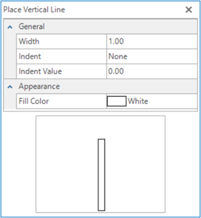

Vertical Line - A vertical line that automatically extends the height of the panel relative to the panel size with either no indent, indent to radius or indent a specific value. Unless overridden, the vertical line width is the same as the panel border width.

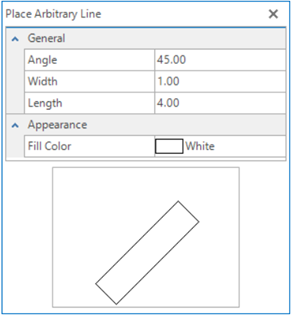

Arbitrary Line - A line with a fixed length, width and orientation. It does not adjust in size or width with the panel. Use an arbitrary line if you want a specified line length.

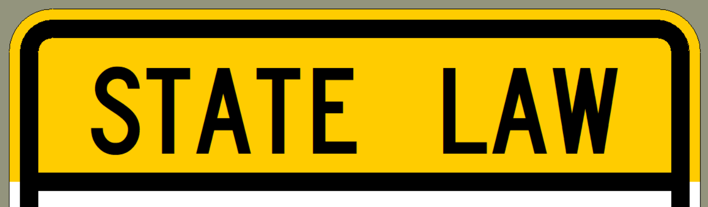

The instructions and video below show how to center a dividing line (22" x 0.625") across two sign panels using an arbitrary line in a 1 column, 2 row tabular arrangement.
1) Pick the Arbitrary Line tool. Set the Angle = 0 and the desired Width and Length values.

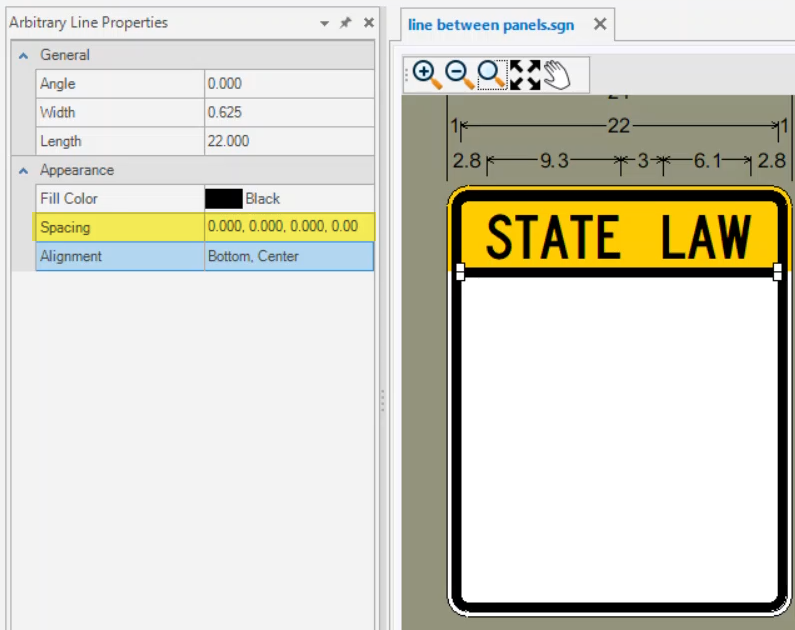

5) Select the tabular arrangement and pick Properties. In the Tabular Arrangement Properties, set a negative Minimum Row Height value equal to half of the diving line height (-0.313). Set the Row Alignment to Bottom and the Spacing for all sides = 0.
6) Select the arbitrary line that is in the tabular arrangement to bring up the Arbitrary Line Properties. Set the Spacing for all sides to a small number (ex: 0.5").
7) Select the tabular arrangement box and place it in the yellow panel below the text.
8) Select the arbitrary line and reduce the Spacing = 0 for all sides and the Alignment to Bottom, Center.
