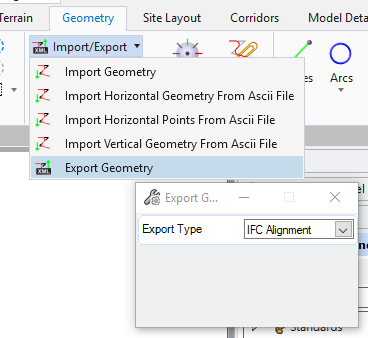

1) To export alignments, go to the Geometry tab > General Tools > Import/Export > Export Geometry command.

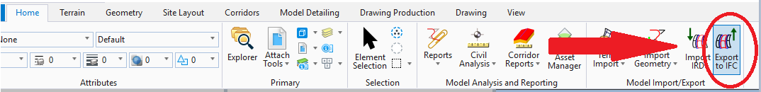

2) To export the design model, go to the Home tab > Model Import/Export > Export to IFC command.
