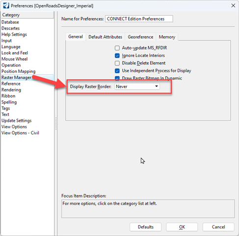

How to turn off/on raster border line display in a dgn
Product(s):OpenCivil Designer
Version(s):10.+
Area: General
Question:
This question came across our support desk. "tif aerial border line showing up in sheet. When turned off the entire aerial turns off. When I go to print, that line across from the tif shows up in the printed sheet. How do I get this raster level to not print while keeping the aerial?"
Answer:
To resolve this issue, toggle on Display Raster Border = Never in your user preferences.
