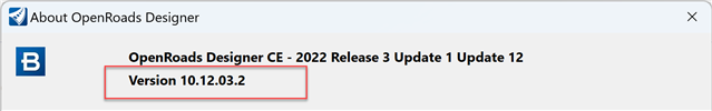

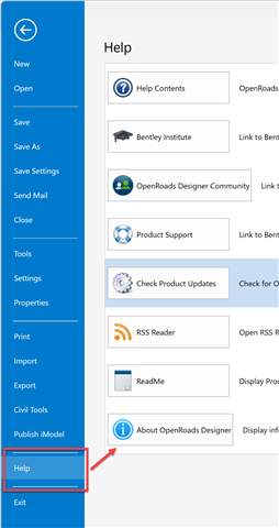

Solution 1
  1. Open any dgn and go to File>Help>About Open(Roads/Rail/Site) Designer
  2. Observe the version number
