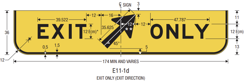

E11-1d Exit Only (Exit Direction) Sign
Product:
OpenRoad SignCAD 2023, 2024 & 2025
Version:
23.00.00.151, 24.00.00.56 & 25.00.00.53
Area:
How-to
Original Author:
Introduction: The video below shows how-to create an E11-1d Exit Only (Exit Direction) sign in OpenRoads SignCAD.

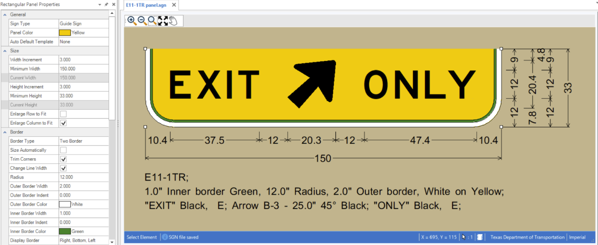

The video below shows how-to edit an E11-1TR Exit Only (Exit Direction) sign to have two different colored borders in OpenRoads SignCAD.
