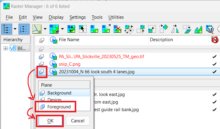

I have images I need placed in my sheets to lie on top of every other graphic. How do I accomplish this?
Answer:
Navigate to the Raster Manager. Click the Plane icon and select Foreground. It will move your image to the front to lay on top of any other graphic in the Sheet.
