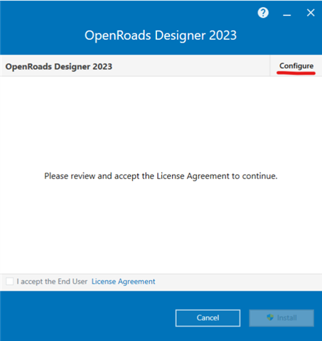

For more detailed instruction follow the below steps
When Installing OpenRoads Designer 2023 click on Configure

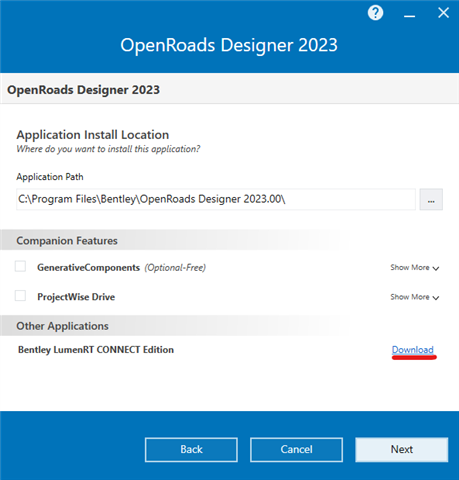

Then it will ask you to download the LumenRT from the official website
You can go the the download link and download Bentley LumenRT Designer
Bentley LumenRT Designer Edition is available to all Bentley CONNECT subscribers at no additional cost.
