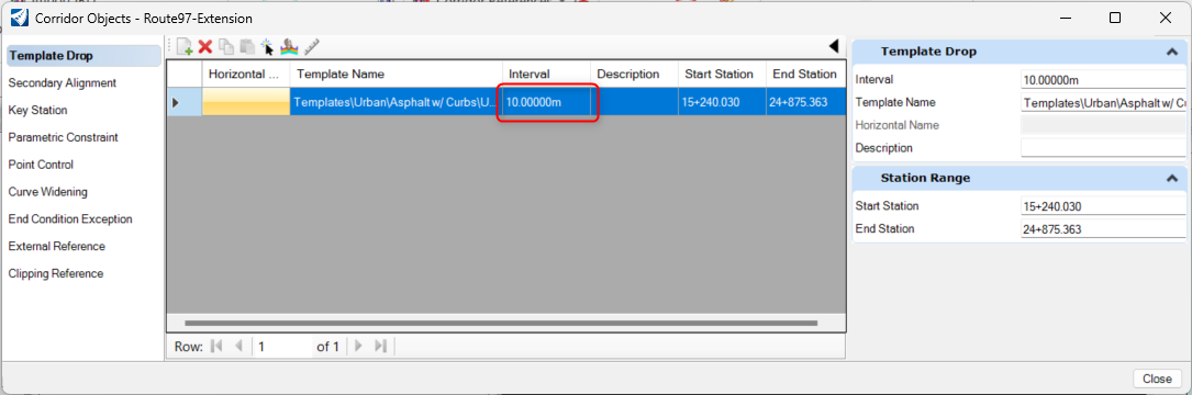

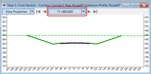

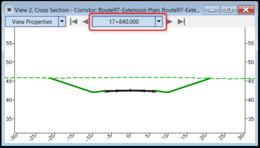

Interval in Dynamic Cross Section View doesn't match the Template Interval - the one I can see in Corridor Object window.
Example: The Cross Section view shows a section every 20 meters, not 10 meters as the Corridor Object window shows:

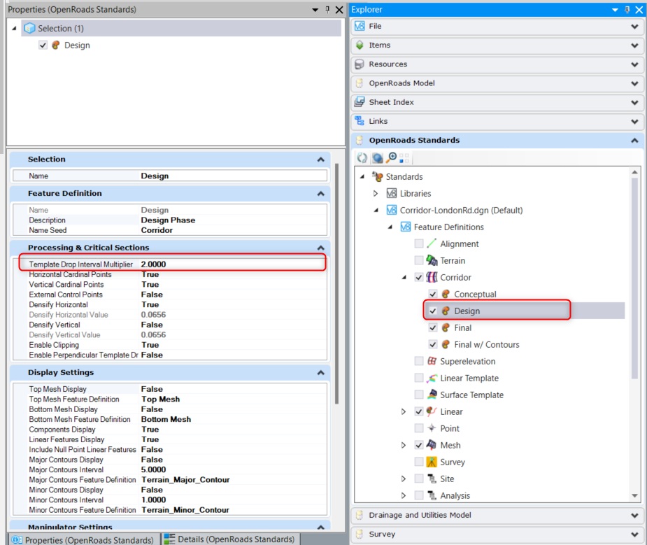

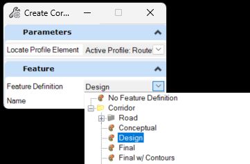

This is due to the Feature Definition that was assigned when the corridor was created:

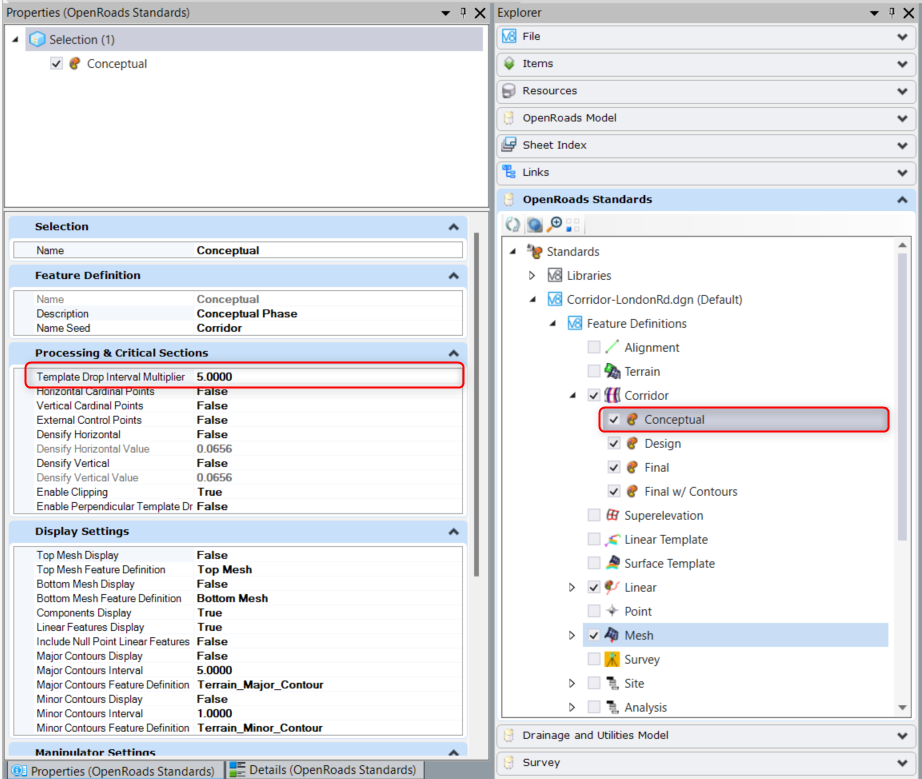

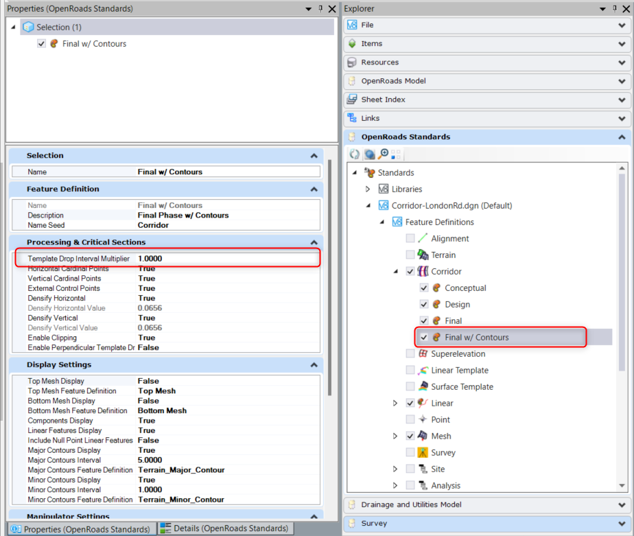

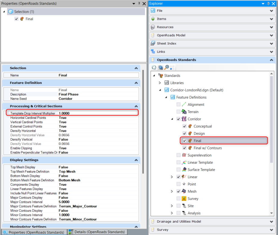

Each Feature Definition definition has a specific "Template Drop Interval Multiplier", which makes the value of the template drop multiplied by just that value.
___
In the example described in "Question", the corridor had a "Design" feature definition assigned, so instead of each 10 meters, a cross section was displayed every 20 meters (10m x 2,000). This value can be changed.
___
