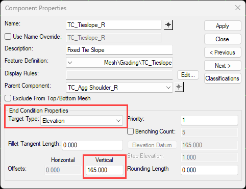

Question : How to target end condition to specific constant elevation value?
Solution : Target elevation can be used to precisely control the vertical positioning of the end condition.
To target end condition to specific elevation open the end condition component properties then set the Target Type to Elevation.
And in Vertical Offset field enter the specific elevation value that end condition to target.
Target End Condition To Specific Elevation
Please note that the Vertical offset field is not a relative offset from any reference when Target Type is set to Elevation.
The value entered in the Vertical Offset field will be directly used as end condition target.
