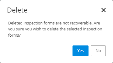

- The following confirmation dialog displays. Click Yes to continue.
A message will display when the form(s) are successfully deleted.

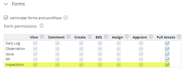

- The user must have full access permissions for inspection forms under the Form permissions for the role they are assigned.
