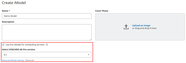

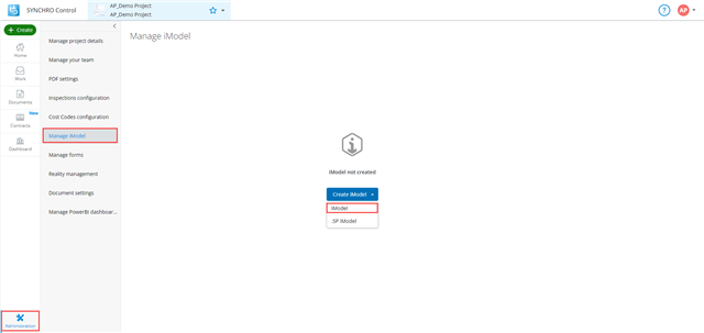

- Open the Administration module at the bottom-left > Manage iModel > Create iModel > iModel.
- Enter the information as necessary.
If you want the iModel to be available for 4D/5D planning and enable collaborative workflows through SYNCHRO 4D Pro, check on the option to Use this iModel for scheduling services.

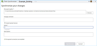

- Select the Create Named Version box and enter a Name for the version.
- Next, select the Synchronize button.

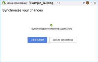

- Once the synchronization is complete select Go to iModel.
