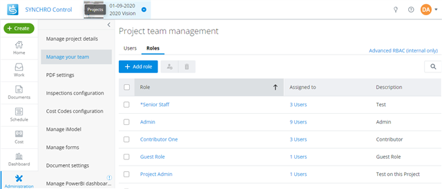

Check Permissions on Control Project if a User Role has the ability to connect to SYNCHRO 4D Pro:
Note: Admins have the ability to check if a Role has the correct Permissions for this functionality
  1. Login to your Control Project at  https://infrastructurecloud.bentley.com
  2. Go to the Administration Module
  3. Go to Manage your team
  4. Go to the Roles Tab. See the below screenshot:

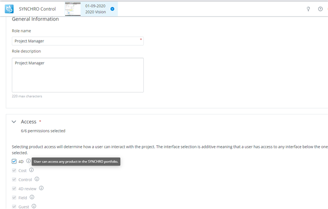

 5. Select one of the Roles
 6. Expand the access section. Ensure that 4D box is checked
7. Click the Save Button at the bottom of the Page

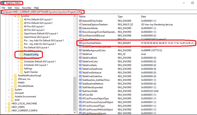

Check that the SynchroHubToken registry entry exists.
  1. When opening a Synchro Control project for the first time you should be presented by access window in your default windows web browser.
  2. Click on Allow - Once this is completed successfully it should create a SynchroHubToken registry entry on your machine.
  3. Close 4D Pro (if it is open) and close the browser where you have Control open.
  4. Type regedit in Windows search bar and hit enter
    ·  In the registry editor, navigate to Computer\HKEY_CURRENT_USER\SOFTWARE\Synchro\Synchro\ProjectConfig
    You should see SynchroHubToken located here.
  5. If the registry entry is missing it is likely that something is blocking the creation.
Deleting the SynchroHubToken
In some cases, it is possible that the SynchroHubToken is having issues.
·  Look for SynchroHubToken in the right panel and delete it
·  Now open 4d Pro and select File - Open -> Control Project
· You should then be able to see your project in 4D Pro

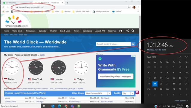

Ensuring your machine clock is in Sync with the World Clock
  1. Check to see if it is possible that your computer time is out of sync? Even a few seconds can make a difference. Please go to the following site to compare machine time to the world clock
  2. "https://www.timeanddate.com/worldclock/"
Make sure the date and time on your computer are synched, once complete try opening the Control project again.

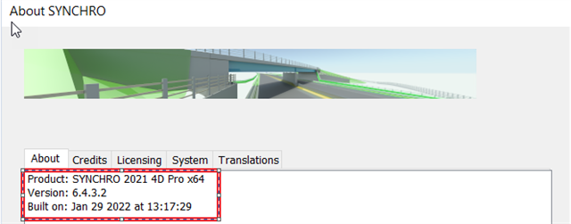

    3. Check your version of Synchro 4D PRO is correct.
      1. Launch 4D PRO
      2. In the upper right hand corner, click on Help
      3. Select About...
