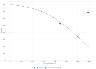

The "Filter to Selected toggle" should be enabled if the user wants to see the combined operating points of the pump station (based on the selection of the pumps that are on for that period). This means that if pump 1 and pump 2 are selected, the values represent the combined pump station operating points when just pump 1 and pump 2 are on (and pump 3 is off). Or if only pump 1 is selected, this means that the values represent the pump station operating points when just pump 1 is on (and pump 2 and 3 are off) - Figure 1.
Figure 1 - Combined operating points when pump 1 and 2 are working simultaneously

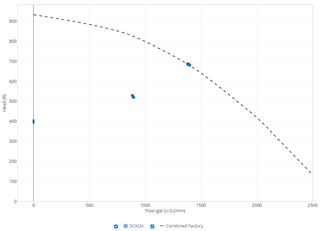

On the other hand, if "Filter to Selected toggle" is disabled, the values displayed correspond to the operating points of each individual pump and not the combined operating points of the all pump station. Only the curve will correspond tothe combined station factory curve.
Figure 2 - Individual pump operating points for pump 1 and pump 2. In some cases Pump 1 might be running alone, in other cases pump 2 might be running alone, and in other cases pump 1 and pump 2 are running simultaneously.

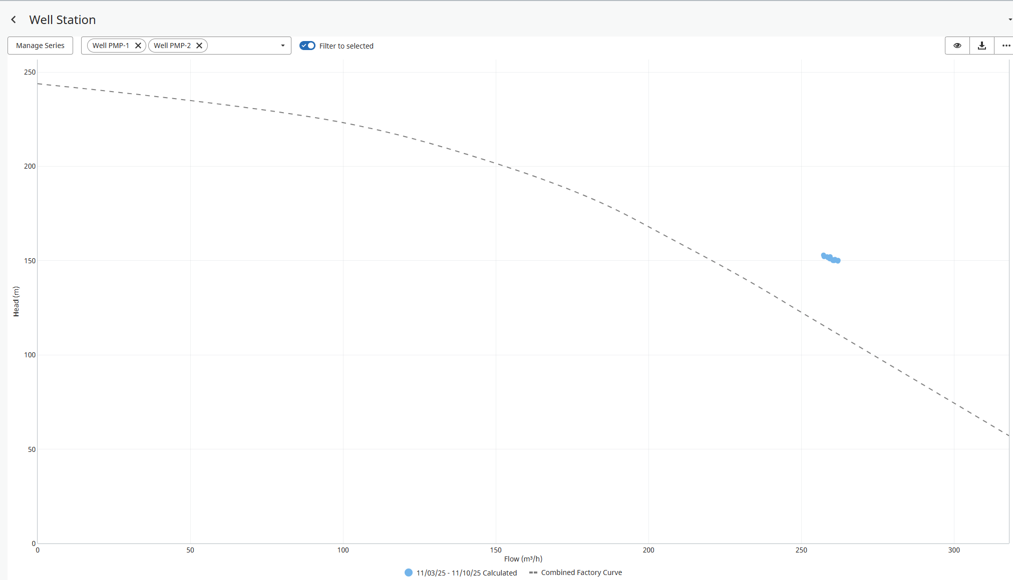

By default this toggle is enabled. When the toggle is enabled, selecting the pumps under the   icon will display the combined factory head curve and the respective combined operating points. If the Filter to Selected toggle is disabled, the selection of the pumps will only update the combined factory head curve (while keeping al the pump station operating points).
