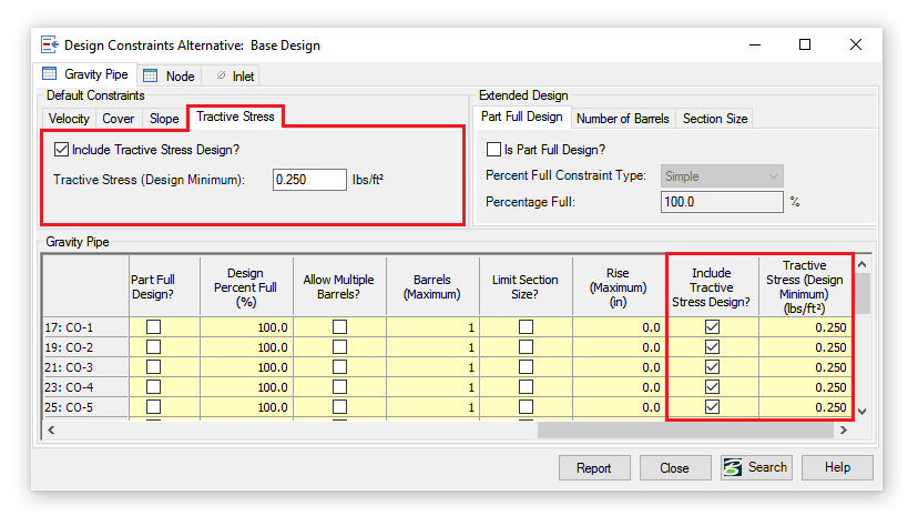

Using Tractive Stress as Design Criteria
Starting with the release of CONNECT Edition (version 10.00.00.40 and later) tractive stress be included in constraint based design.
The tractive stress constraint will not be met if there is a conflict with either the maximum Cover or maximum Velocity constraints.

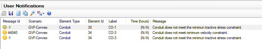

Similar to other design constraints, there will be warnings if the new tractive stress constraint is not met, these warnings are only shown if the tractive stress design is included in the design process (the "Include Tractive Stress Design" check box is checked).

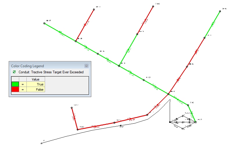

Viewing Results with Color Coding
You can also color code by "tractive stress target exceeded" or "tractive stress target ever exceeded" to visualize:
