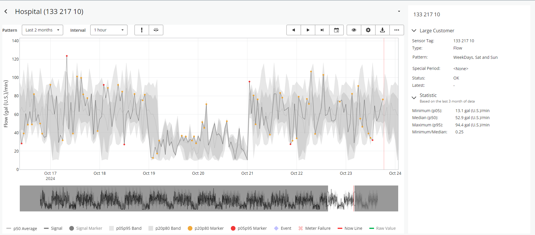

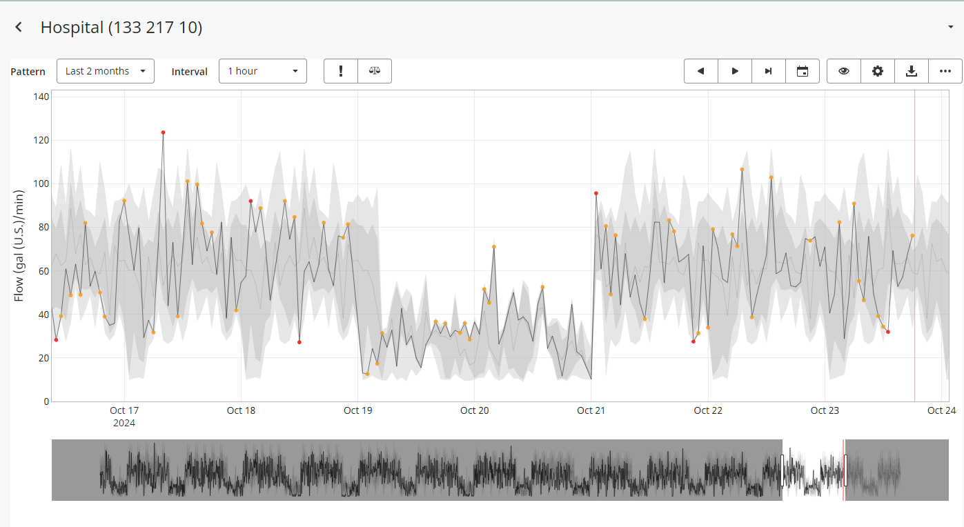

The Large Customer details page shows a detailed chart for a specific sensor. By default the a 3 month signal history will be read.
The chart displays initially a time-window of 2.5 days back into past to 12 hours into future with the range-slider below the main graph turned on. This view is particularly useful to monitor network parameters and to easily spot any anomalies (that can represent internal leaks, anomalous consumptions, etc) in real time. The pattern confidence bands are represented by a grey band, while real (re-sampled) values are represented as a black, red or orange circles. Whenever real data (re-sampled) goes outside the pattern confidence bands (above percentile 95 or below percentile 5 of the pattern), an outlier is identified and the real value is color coded with a red circle. The user has also the option to navigate in the time history series to understand past behaviors or have access to future expected behavior (short-term forecasts), by moving the range-slider below the main graph.

Large Customer Sensor Name
The name of the sensor is displayed above the graph, in the upper left corner. The user can easily switch between different sensors by directly clicking on the down arrow  located on the right side of the sensor name.
Pattern
The pattern confidence bands are represented with a grey color. The Pattern drop down lets the user select the time period for which the confidence bands are based.
The user has the option to define the historic time range to be used to compute these pattern confidence bands: last month, last 2 months, last 3 months, last 6 months or last year of data. If there is not enough historical data to compute the pattern confidence bands an informative message is displayed, and only real (re-sampled) values are shown. Clicking on this message removes the message. Patterns can be customized by the user in the Administration page, under Settings > Pattern.

Interval
Specifies on the one hand the rate at which raw signal readings are re-sampled (15min, 1hour, daily) and on the other hand how the sensor information is charted.
All 15 minutes values and hourly values are evaluated looking backwards. For example if the value at 9h15 is 10 l/s, this represents the re-sampled value from 9h00 to 9h15. If the hourly value is 20 l/s at 10 AM, this represents the re-sampled value from 9 AM until 10 AM. All daily values are evaluated for the specific day that is being displayed. For example if the value for day 10th is 20 l/s, this value is calculated for the time period between 00h:00mm and 23h:59mm of day 10th.

Selected Sensor
Field Description
Id Scada ID/Tag of the sensor
Type Kind of measurement
Status Status obtained from number of signal readings in the selected signal time range and the expected number of readings.
Latest Timestamp of most recent signal reading
Statistic
Field Description
Minimum (p05) Percentile 5 of the historical time period defined by the user (default is last 3 months), for the integration type time-series defined.
Median (p50) Percentile 50 of the historical time period defined by the user (default is last 3 months), for the integration type time-series defined.
Maximum (p95) Percentile 95 of the of the historical time period defined by the user (default is last 3 months), for the integration type time-series defined.
Minimum/Median
Ratio of "Minimum (p05)"and "Median (p50)" of the of the historical time period defined by the user (default is last 3 months), for the integration type time-series defined.
