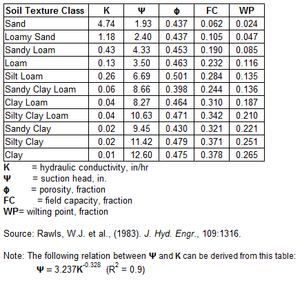

  • Green-Ampt: The Green- Ampt infiltration method is used to compute the pond seepage loss, in which suction head, conductivity and initial deficit data are required.
    Note: - this method considers the surface area over the sides, not the total wet cross section area of the sides. The SWMM solver takes into account variation of depth over the pond banks, by taking the depth average when computing the infiltration rate using the Green-Ampt method (see more details further below).
    • Suction Head: Average value of soil capillary suction along the wetting front (inches or mm)
    • Conductivity: Soil saturated hydraulic conductivity (in/hr or mm/hr)
    • Initial Deficit: Fraction of soil volume that is initially dry (i.e., difference between soil porosity and initial moisture content) The initial deficit for a completely drained soil is the difference between the soil's porosity and its field capacity. Typical values for all of these parameters can be found in the Soil Characteristics Table.
