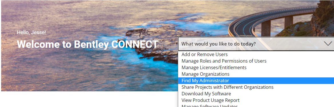

NOTE: If another person in your organization manages your Bentley OpenFlows licenses (such as your IT or HelpDesk administrator), please share the following information to guide them through the upgrade. A list of your Administrators can be seen by going to https://connect.bentley.com. On the right side of the Welcome Banner, click the dropdown and select "Find my Administrator". In the next screen, scroll to the bottom and expand "Account Administrators".

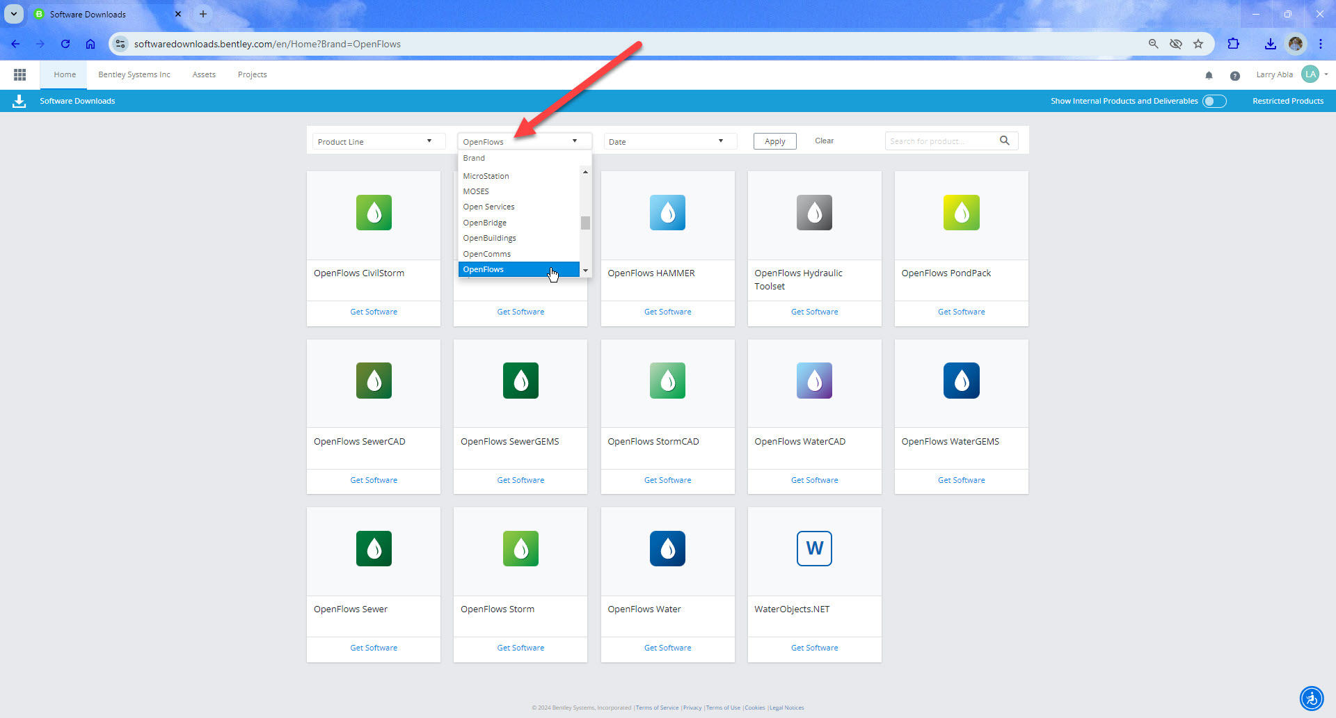

2) Locate the desired product(s)
Select OpenFlows from the Brand pull-down menu and click the Apply button to see the latest OpenFlows products.

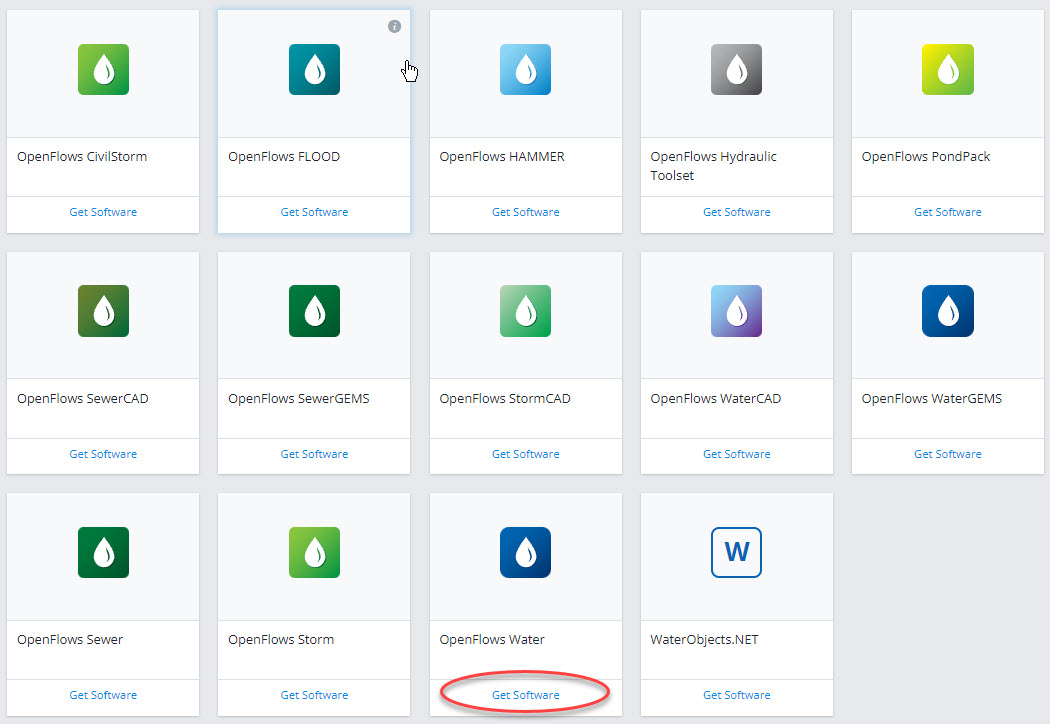

3) Download the desired product(s)
When you see the product you want to download, simply click the "Get Software" link on the tile:

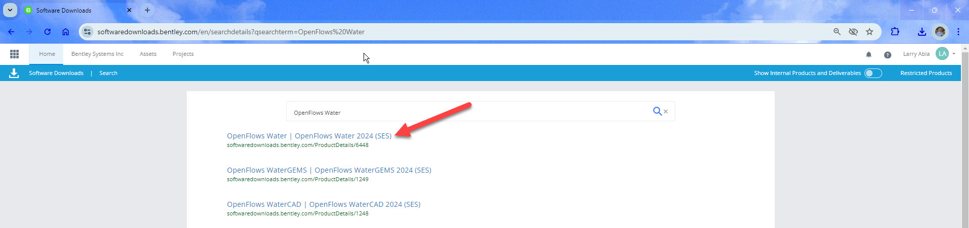

Next, click the first link in the search results for the latest version of the product you want to download:

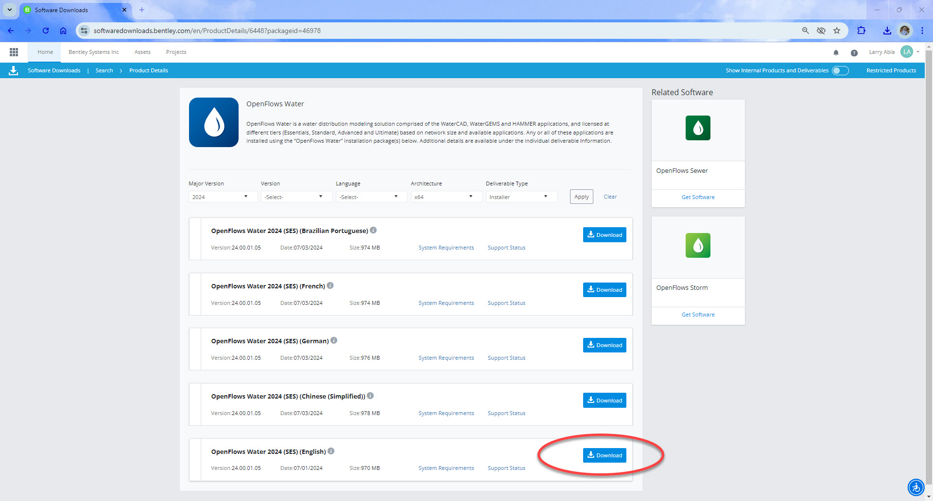

After selecting the product, you should see a list of available versions of the product. If the expected product/version does not appear in the list, click the "Apply" button to be sure that all of your search criteria is included in the Search Results. If you still have trouble, click "Clear" and then "Apply", then re-select your filters and "Apply" again.
You can also use the available filter dropdown fields to further refine or alter your search.
In the list of versions for your selected product, click the blue "Download" button to the right of the version you want to download.
