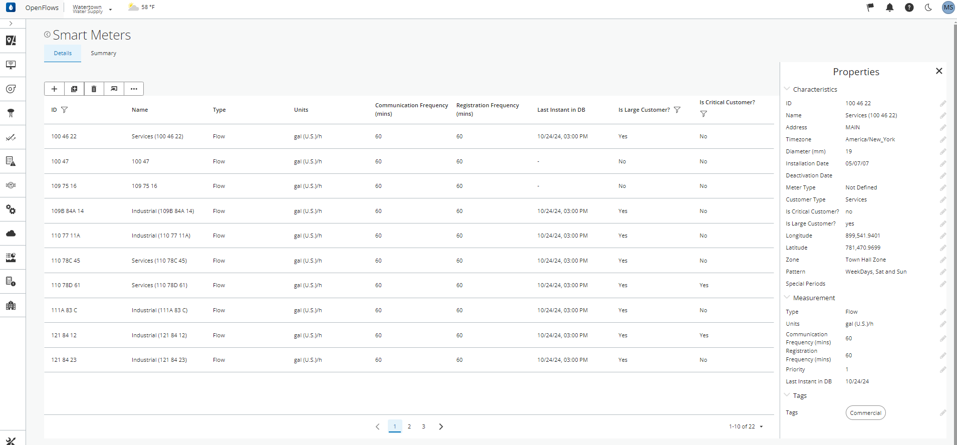

It is possible to import smart meter information through a configuration excel file (template file available for download in the Digital Twin Setup page) or to manually add those. After uploading information, it is also possible to edit, delete or copy information, using the available buttons located above the table.
Note: To enable the Copy, Edit and Remove options, please select a smart meter first (row in the table). When clicking in a specific smart meter (table row) the fields available for editing will appear on a right side property grid.
