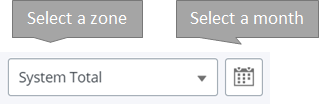

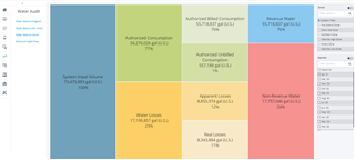

Displays a "Water Balance Diagram" with the volumes for their respective categories according to AWWA and IWA standards. The water balance diagram is calculated based on the explanation below. The buttons above the diagram control the zones for each the Water Balance is displayed, as well as the period selected
Zones should correspond to isolated areas of the system, surrounded by closed valves and where all inflows and outflows (if exist) must be measured. Zones can include for example DMA (District Metered Areas), pressure zones or operational zones. The configuration of the inflow and outflow sensors as well as tanks levels that may exist inside the zone are configured in the Zones configuration page (at the administration level) by the user.
Regarding the period to analyze, the list allows to select a single month or multiple months for volumes aggregation.

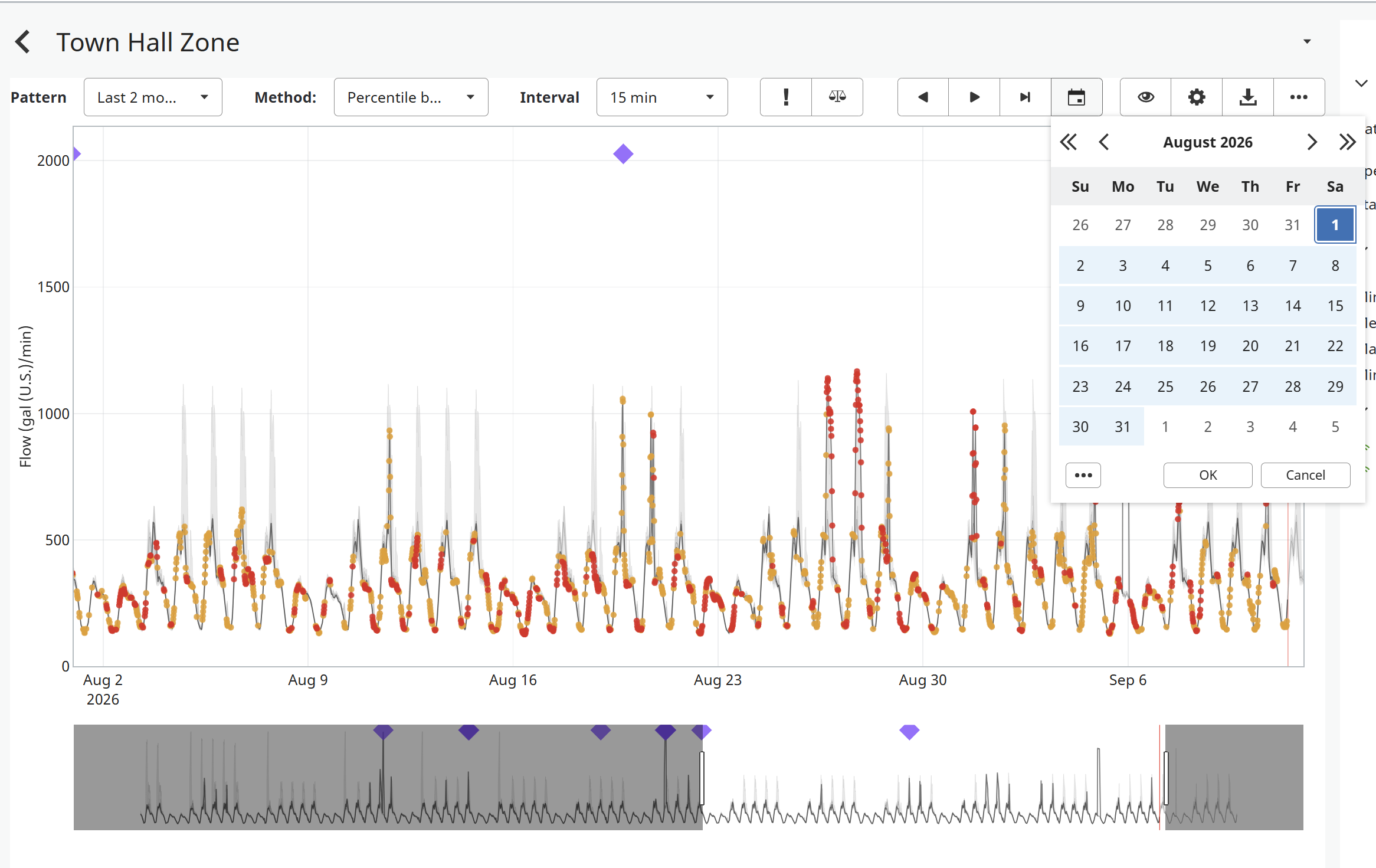

In order to check if there is enough zone data available for the specific month:
1- Go to Network Monitoring >> Graphs >> Zones. Select the zone to enter in the graph detail
2 - Once in the zone graph detail, update the time interval to 15 minutes and check if there is data available for the all month or if gaps are less than 25% of the time (you can use the calendar button to select all month)

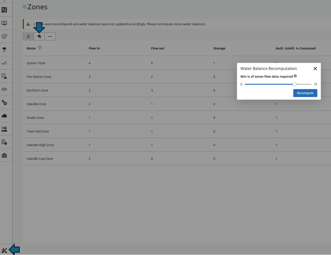

3 - if there are a lot of gaps in the data (more than 25% of the time) and you still want water balance to be calculated, go to the administration >> Zones and press the recompute button located on the top of the table, under the more (...) button, and select a lower percentage of minimum data required.

7- after meter failures events are updated, make sure to go to the administration >> Zones and press the recompute button located on the top of the table, under the more (...) button, to force the recalculation of the water balance data.

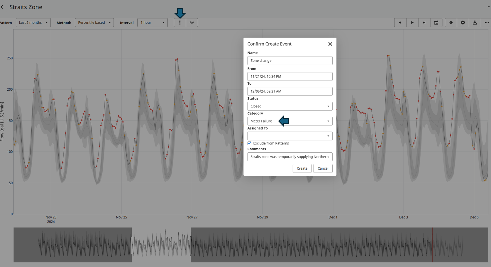

If a zone had invalid data for a specific period that should not be considered for the system input volume calculation of the zone (for example one of the sensors that belongs to the zone failed or there was a temporary zone boundary change or supply to other zones), it is possible for the solution to ignore that period and use the pattern value instead for the same period. The steps are the following:
  1. Access the zone graph detail and zoom to the period that should be ignored
  2. Add a manual event for that period by clicking in the   button above the graph, and define the event category as meter failure. You can also close the event (so it will not get displayed in the active event list and in the map) and make some comments. See image below. After the meter failure event is created it will be highlighted in the sensor graph with a red cross symbol. The user can create multiple meter failure events if there are different time periods he wants to ignore.
          3. If the event has occurred in the past month or even before, you will need to force again the re-computation of the zone system input volumes. Go to the Administration >> Zones >> click on the recompute water balance button () located above the table. See image below.
          4. In the pop-up that gets displayed the user can define the minimum amount of data that will be required each month to calculate the SIV. For example if 75% is defined, at least there needs to be data available for 22 full days each month. For the remaining missing days an estimation will be done using the pattern values (it is suggested to reduce             this threshold to 60 or 50%). See image below.
          5. The real data for the period defined as meter failure event will not be used for the SIV calculation. Instead, the pattern values for the zone (the grey line in the graph)  will be used for that period.

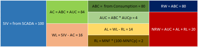

Revenue Water and Authorized Billed Consumption
These components are automatically calculated from the billings obtained for each zone zone (based on the customer billing files and customer meters characteristics file uploaded at the Administration level). It is important to assure that customer meters information (billings and meters geolocation) is up to date, to assure reliable computations of the revenue water per zone. Ideally, this information should come from the billing system.
Non-Revenue Water
The difference between the System Input volume and the Revenue Water.
Authorized Unbilled Consumption
This value is defined by the user in the Zones Configuration page, as a percent of billed consumption. If no value is defined by the user, WaterSight will assume zero.
Authorized Consumption
This is a calculated value. It corresponds to the sum of the Authorized Billed Consumption and the Authorized Unbilled Consumption.

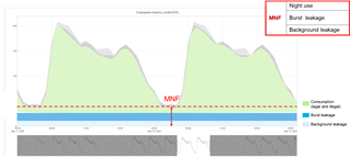

Real Losses calculation based on the minimum nightly flow (MNF)
This component is calculated based on the minimum nightly flow (MNF) of each zone, for each month. The MNF is calculated using statistical analysis, based on the percentile 5th of the zone flow time series and is available in Zone Report, under Daily Minimum tab.
The MNF occurs when the consumption is the lowest inside the zone, and usually this occurs during the night between 2 AM and 5 AM where most people are sleeping and therefore most flow is assumed to be real losses (burst leakage and background leakage), as exemplified in figure below.
Figure 1 - Decomposing the zone flow time series
There are however some exceptions where some zones may have significant consumption during the night such as industrial zones or areas with bars and hotels or tourist places. In those cases, it is important to assess the night consumption or use other methods such as the top down approach (estimating first the apparent losses).
In the Zones Configuration page the user can define a percentage of the MNF that is due to consumption, in order to exclude the minimum nightly consumption from the real losses volume calculation. If no value is defined by the user, WaterSight will assume zero, and a conservative value will be calculated. For more information about estimating night consumption, you can take a look here.
To mention that real losses volumes are being calculated based on a MNF, assuming that the real losses flow (calculated by subtracting the zone MNF to the MNF consumed) obtained during the night period is constant along the day. This is assuming that pressure does not change very significantly along the day for each zone (night day factor is assumed to be 24 hours). Results must be analyzed carefully in case there are significant pressure changes along the day inside a particular zone. In this case the real losses flow can significantly change along the day (usually real losses flow is higher during the night when pressures are higher, and is lower during the day when pressures are lower).

Apparent Losses
If the water losses method considered (defined by the user in the Zones administration) is to calculate real losses based on the minimum nightly flow (where night consumption is also accounted) - default method - then in this case the apparent losses component is obtained by subtracting the real losses to the total water losses.
Another approach is having WaterSight directly calculating the apparent losses component. WaterSight can calculate apparent losses based on:
The methodology to use is defined by the user in the Zones administration
Water Losses
Calculated as the difference between Input Volume and Authorized consumption.

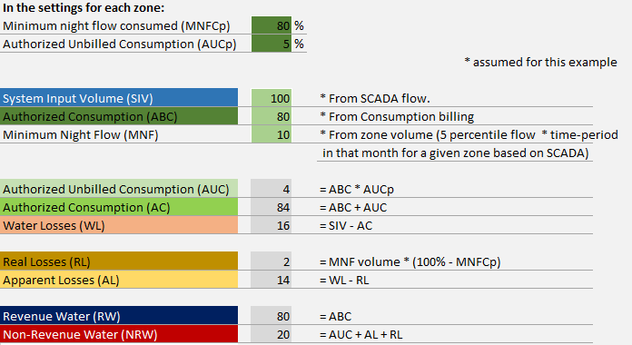

Calculation Example
Example of a Water balance calculation (real losses calculation based on the MNF):
