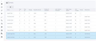

Zones Configuration table
Column Description
Name*
Required field. Zone display name that will appear in the software. This name should be the same used in the shapefiles uploaded in the GIS configuration page.

Parent Zone
If there are smaller zones defined inside bigger zones, the user needs to define which is the parent zone. By default System Total is defined. More information about zones hierarchy below.

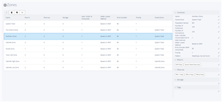

Flow In*
Required field. Number of sensors measuring flow into the zone. To define/edit the inflow sensors, just click in a zone (table row) and then click in the edit button above the table. Below the table will appear the "Flow in" sensors to configure. There must be at least one inflow.
Flow Out
Number of sensors measuring flow out of the zone. To define/edit the outflow sensors, just click in a zone (table row) and then click in the edit button above the table. Below the table will appear the "Flow out" sensors to configure.
Storage
Number of sensors measuring tank levels, inside the zone boundaries. To define/edit the storage sensors, just click in a zone (table row) and then click in the edit button above the table. Below the table will appear the "Storage" sensors to configure. As an important note, the tank levels that should be considered for the zones balance are only those that are inside the zones boundary and serve as storage for the zone - this means that if a zone is supplied by a tank and the inflow sensor is located immediately downstream the tank (and already considered for the zone balance as input), this tank level must NOT be considered.
Tags Tags allow to group zones inside the application, so it is easier to search and find specific zones of interest.
Tags (User defined groups)
It is possible to insert tags (or user defined groups) for each zone by directly clicking in a row in the Zones table, then clicking Edit    and then filling the Tags section below the table.

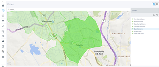

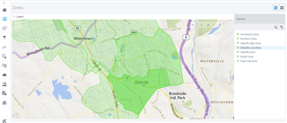

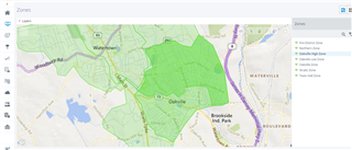

Most utilities manage their systems based on bigger zones (usually called operational zones or distribution systems), being each operational zone or system composed by several smaller zones (usually called DMA). In WaterSight it is possible to consider these two levels of zones hierarchy, but it is also possible to consider three or more levels of hierarchy (for example a town, that is composed by several distribution systems, being each system composed by several DMA). The highest zones in the hierarchy will have System Total as their parent.
Distribution system - Oakville Zone DMA - Oakville Low Zone DMA - Oakville High Zone
In the example above, it is being considered a bigger zone (Oakville Zone) that is divided in two smaller zones (Oakville Low Zone and Oakville High Zone). In this case, in the zones configuration table, both Oakville Low Zone and Oakville High Zone should have Oakville Zone as their parent (example below).
