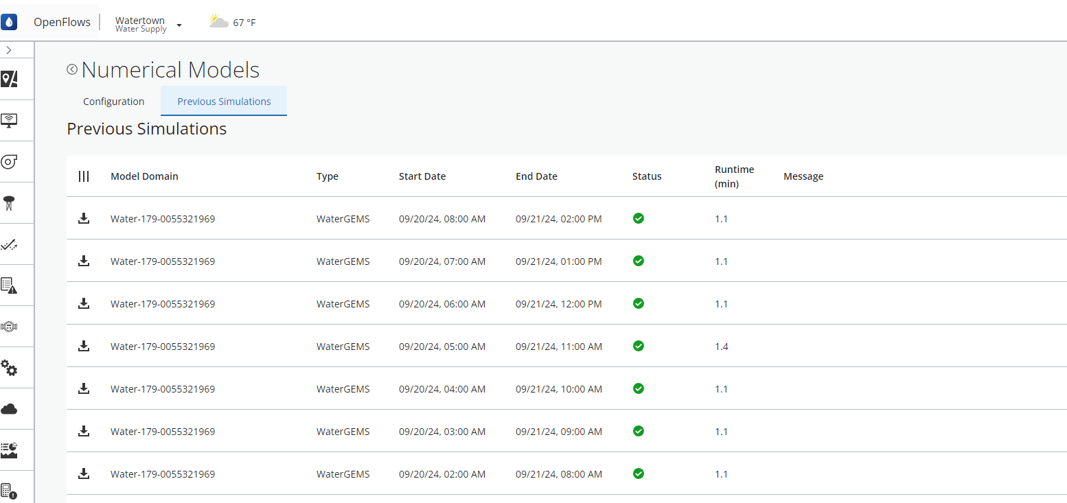

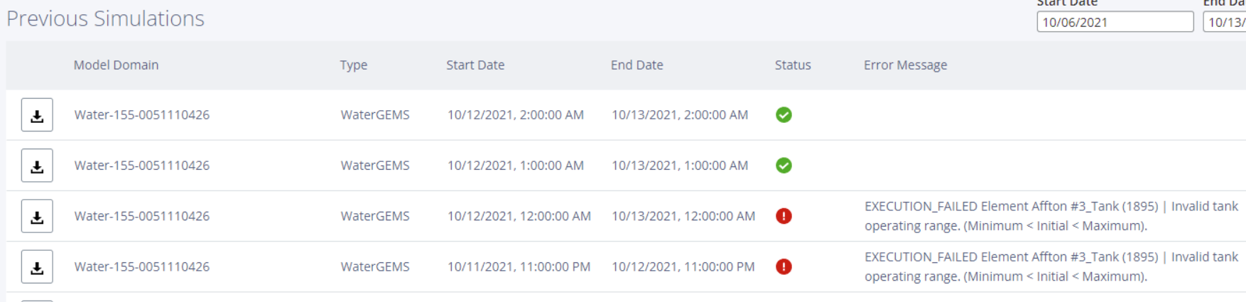

Results from every automatic run of the model in WaterSight are saved in this page and can be downloaded by the user for further analysis using WaterGEMS or WaterCAD. Each row of the table lists one complete run of the model. The respective model with the results can be downloaded by clicking in the icon button located on the left of each Model Domain. The frequency at which each model run is saved depends on the run frequency defined in the Numerical Models configuration page.
Model Domain
Automatic name generated by the software once a hydraulic model is uploaded through the Numerical Models configuration page.
Type
Model input format. For now it is only possible to upload WaterGEMS models.
Start Date
Corresponds to the time the model was computed.
End Date
The time for which a new model run will be calculated. This depends on the run frequency defined in the Numerical Models configuration page.
RunTime (min)
The time it took for a complete hydraulic model run.
Status
Shows if the model was computed with success or not. If green the model computed successfully. If orange warning symbol, the model run with success but with some warnings. If red, there was an error and it was not possible to run the model, therefore the latest model results will not be available in WaterSight.
Message
Warnings and error messages are displayed in the Message column.

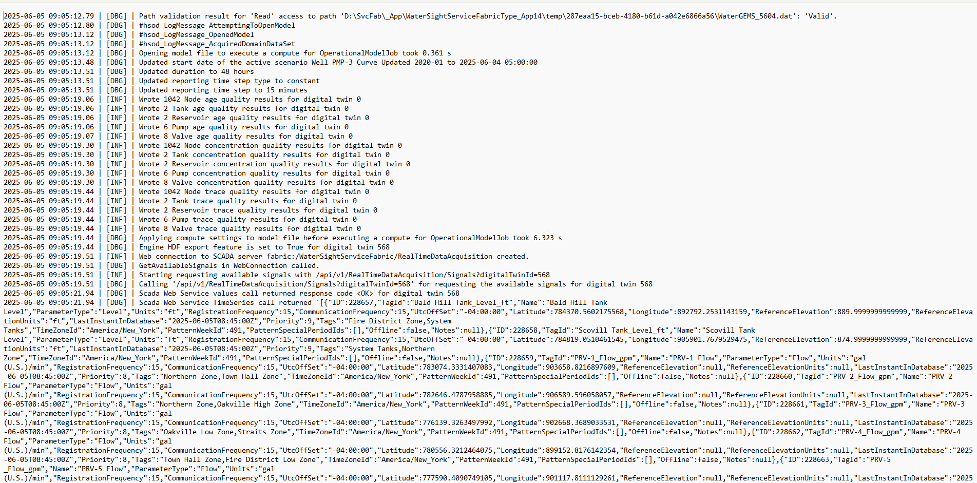

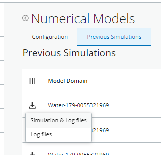

More detailed information and messages for each model run can be found by downloading and opening the logs file:
Figure 1 - Log file example for a specific model run

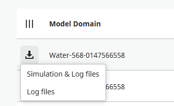

A summary of the potential errors is listed under the "Messages" column in the Previous simulation page, as described above. For more detailed message errors the user should download the model run which had problems and download the simulation and log files (this log file can also be downloaded from the operational response simulation page in case the operational model runs - pipe break, fire event, pump shutdown, valve operations - are failing).

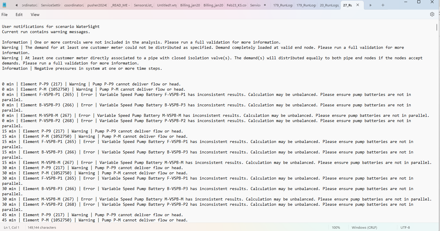

Inside of the downloaded zip file open the UNS file extension and look for an extensive detail of all possible errors and warnings, example below.
Execution Failed - Invalid Tank operating range
If the model fails with the message Invalid Tank operating range, this means that value assumed by the hydraulic model for the tank operation is below the minimum or above the maximum. Example of the error message below:

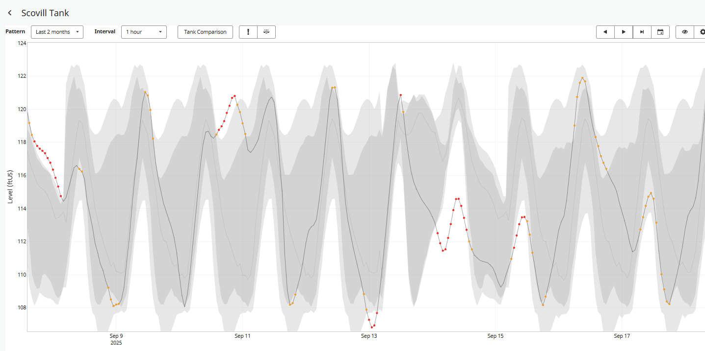

In case you are using real tank levels to override tank model boundary conditions (in case you have in the WaterGEMS uploaded model the sensor level defined as SCADA element and mapped to the tank model element), most likely that one of the sensor level values (real value) registered at least one value that is outside the max and min tank operating condition defined in WaterGEMS uploaded model.

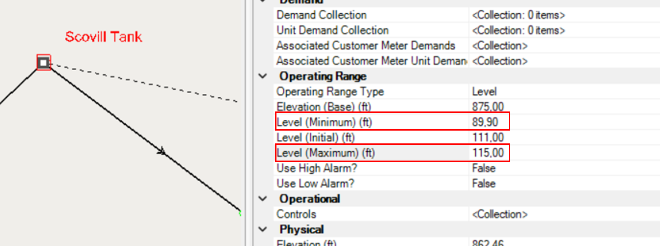

For example in example below, the Scovill Tank was configured in the uploaded WaterGEMS model to have a minimum level of 89 ft and maximum of 115 ft.
And if we look into the Scovil tank levels in WaterSight, we can see that the sensor goes several times to more than 115 ft:
As this model element is associated with a SCADA element in the model, the real time measurements (more than 115 ft in some cases) are being input into the model and this is making the model to fail (as it only allows max level of 115 ft).

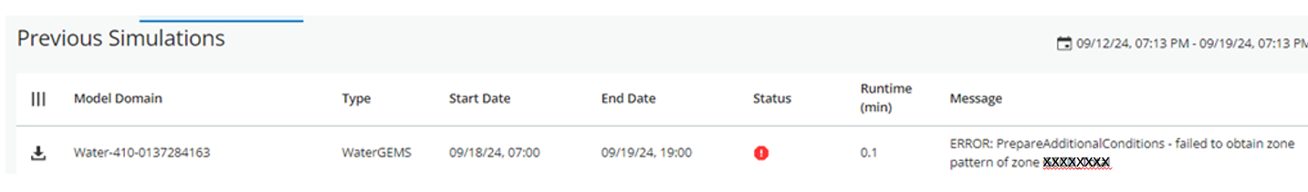

ERROR: Applying reservoir Pattern - failed to compute reservoir pattern
This situation typically happens when the automatic HGL demand adjustment option is enabled for the model (configured in the Administration >> Numerical Modelling >> Configuration) but there are no level patterns available for those reservoirs/tanks.
Troubleshoot steps - check if there is level signals is arriving to WaterSight and level patterns are available:
1 - Go to Network Monitoring >> Graphs
2 - Click in the level graph you want to analyze (in the title). This will enter in the level graph detail.
3 - In the level graph detail change the pattern option to last month, and check that 15 min series values (signal values) exist as well as the pattern bands (grey bands) and those are not flat lines. If signal values or the pattern last month is not displayed or is a flat line, than it will not be also possible to use it for the hydraulic model run and the model run will fail in case it is using this the option to use HGL pattern to adjust reservoir levels.

Note that while an error prevents the model to run at all (and no model results will be available for that run), a warning will not prevent the model to run, but the user should be aware of potential situations that can affect the results. Some examples are described below.

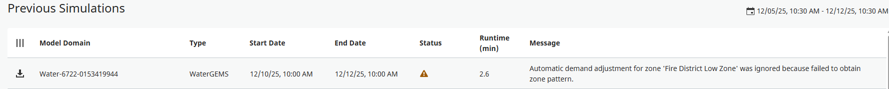

Warning when obtaining zone pattern
A common warning might be related with a failure obtaining the zone pattern:

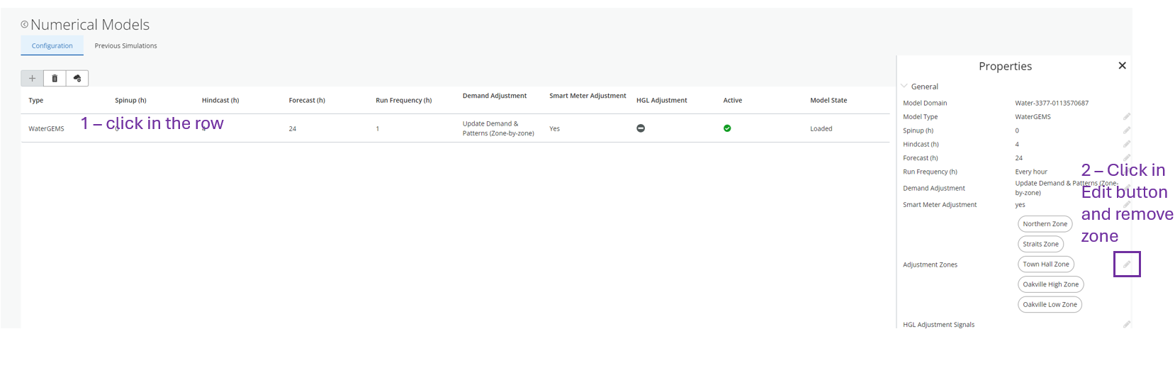

This situation happens when the automatic zone demand adjustment option is enabled for that zone (configured in the Administration >> Numerical Modelling >> Configuration) but there are no flow patterns available for that specific zone.

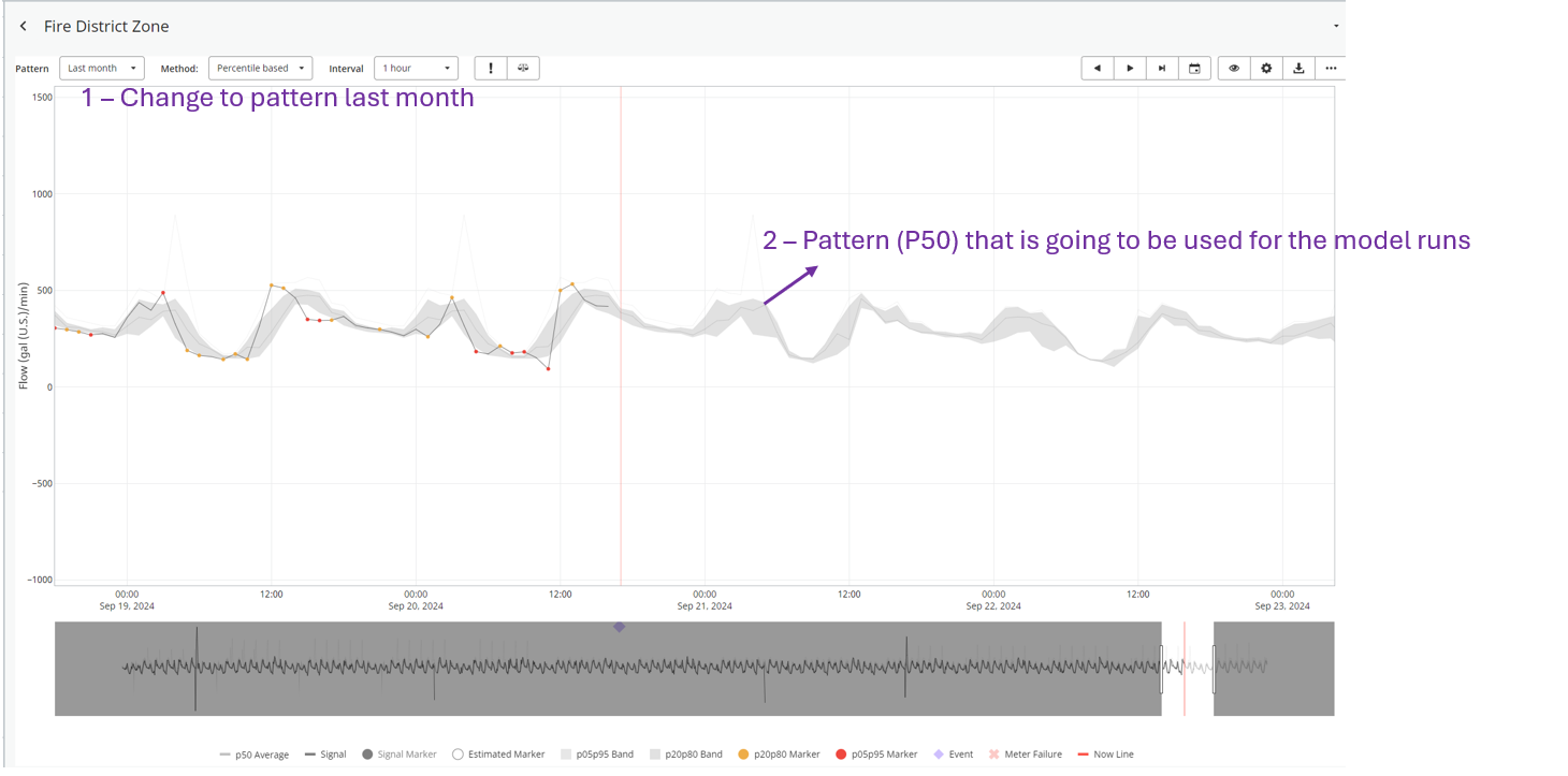

Troubleshoot steps - check if there is zone flow pattern available:
2 - Select the Zone Overview Dashboard, by clicking in the zone button located on the top right of the page
3 - Click in the zone graph you want to analyse (in the title). This will enter in the zone graph detail.
4 - In the zone graph detail change the pattern option to last month, and the time series to 15 min, and check if pattern (grey band) gets displayed or not in the graph for the period that fails (or if it is a flat line). If the pattern last month is not displayed or is a flat line, than it will not be also possible to use it for the hydraulic model run and the model run will fail in case it is using this zone to adjust the demands. This might happen due to one of the reasons below:
