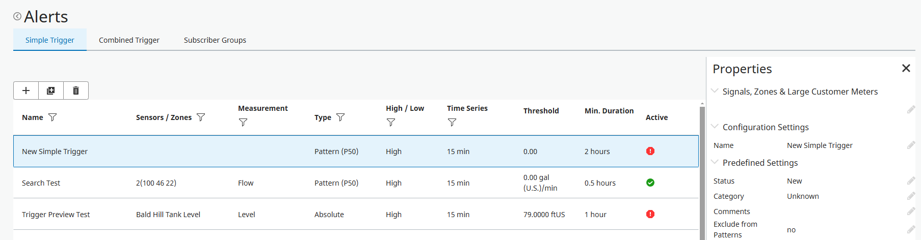

Simple Trigger
The Alerts administration page is used to setup the triggers for the alerts. To create a trigger, the use picks the "+" button in the menu below which is located at the top left of the page.
This creates a new row in the Alerts config table. Highlighting a row enables the user to copy, edit or remove a row. Picking edit, enables the user to set up the alert, using the right side panel.
Properties: Signals, Zones, Large Customers
Select the sensor(s), zone(s) or large customer signal(s) that will be associated with the trigger. For more information regarding triggering alerts for zones vs sensors, please click here. Each trigger can include one or more signals.
Once the signals are selected, more options will appear under the configurations settings section.
Please note that each trigger can only be applied to the same type of measurement, which can include several signals. This means if the user wants to set triggers for flow, pressure and level, it is required at least to set up three different triggers.

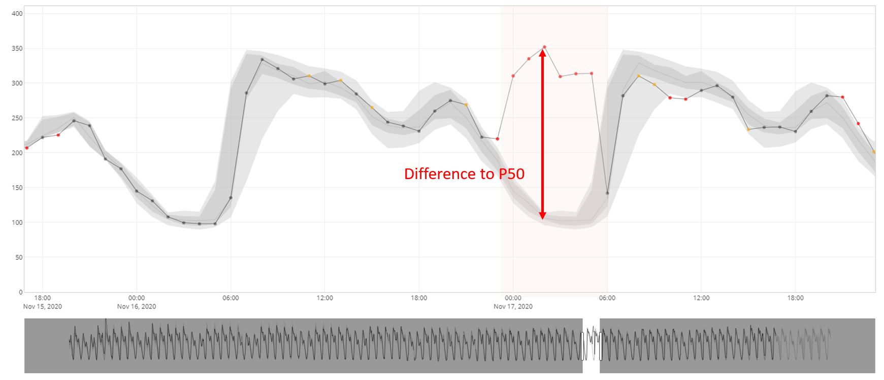

The figure below illustrates a pattern based alert considering a numeric threshold, that uses the pattern as a reference.
Figure 1 - Pattern based alert.
Taking alert above as an example (Figure 1), the alert gets generated because:

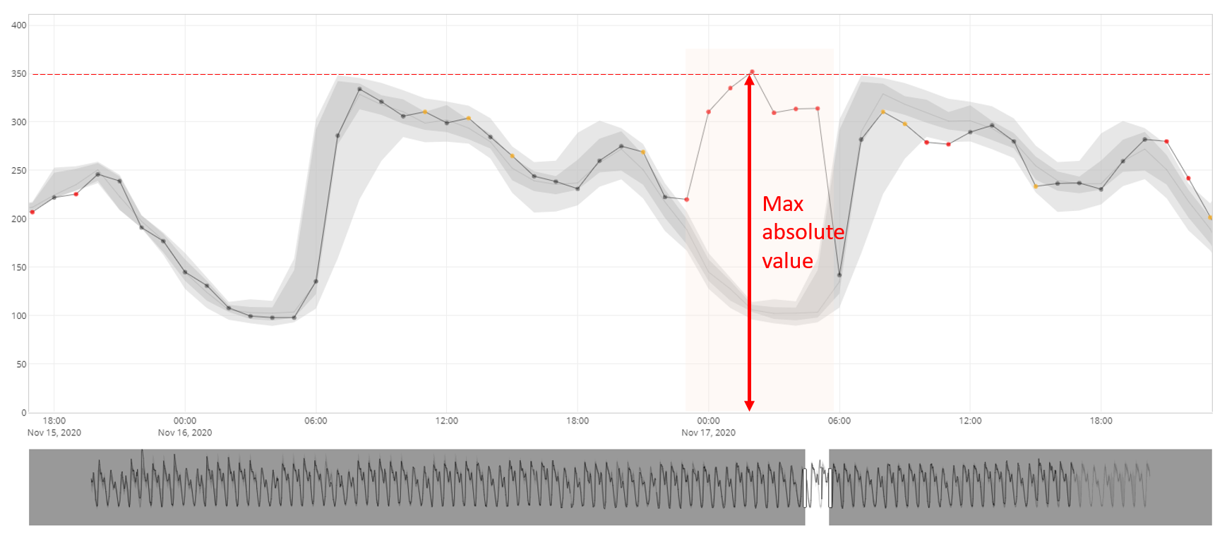

Type - Absolute
Absolute based alarms are evaluated directly by comparing real time series values with the user defined threshold. For this type, alerts are generated if all below conditions are simultaneously met:
An alert informs about an event that may be occurring in the network. Once an absolute based alert is generated, volume lost and duration of the event are automatically computed (more information on the Active Events help page). The event automatically ends whenever real values are below (for hight type) or above (for low type) the absolute numerical value defined by the user.
Absolute based alarms do not look at the sensor patterns and are useful to identify situations that do not depend on the sensor or zone pattern, like for example problems related with pressure service requirements - pressure below the minimum or maximum required by law - or tank overflows (see this article for some tips how to configure absolute type of alerts).
Figure below illustrates an absolute based alert that uses the zero reference.
Figure 2 - Absolute based alert.
Taking alert above as an example (Figure 2), the alert gets generated because:

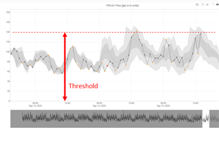

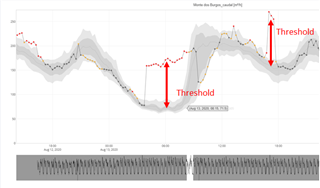

Threshold for Pattern - type alerts
For Pattern type alerts, two types of thresholds can be defined:
 For burst detection, this numeric threshold usually defines what is the leak/burst flow needed to trigger the alarm.

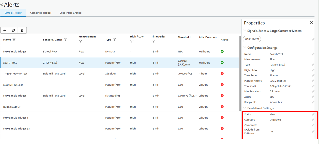

Properties: Predefined Settings
By default all the events that are automatically generated will have a status "New", a category "Unknown" and the option "Exclude from Patters" set to No.
These are the default configuration that will be displayed in the application, for example in the Active Events List.
The user may want to override the defaults by specifying these fields for the automatically generated events. Some common examples include:
When changing the default settings under the Predefined Settings one suggestion is to only change the option "Exclude from Patterns" to Yes for the Flat reading alert types, as those will be most of the times real data issues that make sense to ignore from the pattern calculations. When setting other type of triggers, the generated events might catch other issues such which periods should not be excluded from the pattern calculation. Therefore it is better to make this decision after the event is generated and once the real reason of the event is identified. In fact this option can and should be updated later once managing the events from the active events list. More information here, Active Events .
