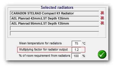

How can a margin be considered in the Heat Loss program?
Method
The Heat Loss program does not allow you to consider a margin, however, the Radiator sizing program allows you to select a multiplying factor to allow for oversizing. Note that if you have fixed a radiator or emitter solution for a room, you must unfix the solution before changing the multiplying factor.
