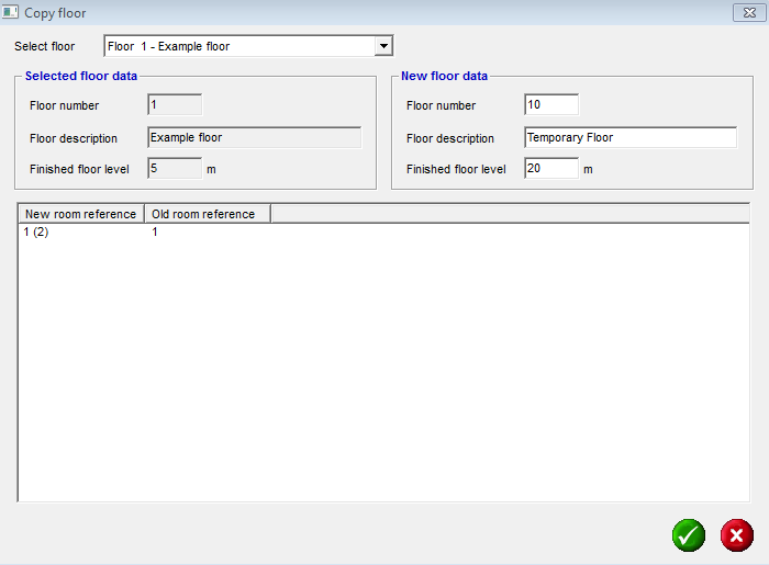

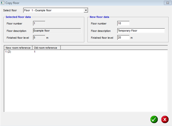

Step 1: Using the Floors>Copy floor command, copy the floor in question to an arbitrary height – making sure that the new floor does not overlap any of the existing model. Note that this will be a temporary floor. Using 20m in this instance:

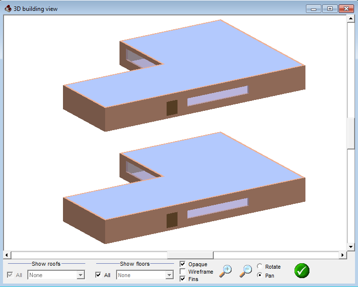

It is advisable to inspect the 3D view at this stage; it should look something like the following:

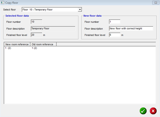

Step 3: Using the Floors>Copy floor command, copy the temporary floor created previously to the correct floor height of 6m:
Step 4: Finally, Delete the temporary floor. The remaining floor should then have the correct floor height of 6m.
