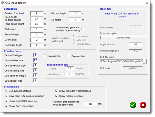

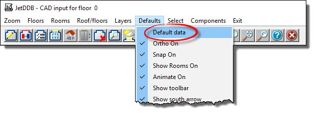

It would be prudent to familiarize yourselves with the Defaults options in CAD Input. This provides options for setting grab distances for adjacencies and snap accuracy along with other useful features that will help with your design.

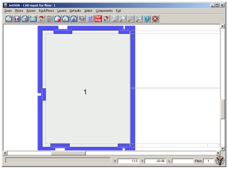

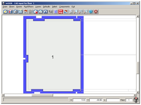

Intricate surfaces and room layouts
There are instances where a room layout may contain unnecessary surfaces and recesses:

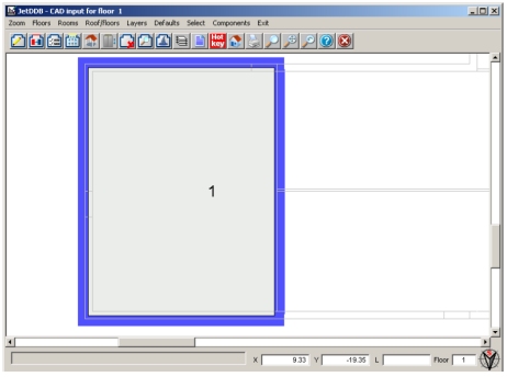

For Design Simulation or PartL, this would generate a number of extra surfaces which will slow down the calculations.  This room could be defined as follows with very little impact on the end calculations:

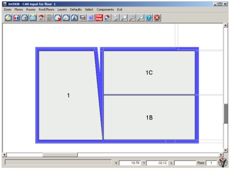

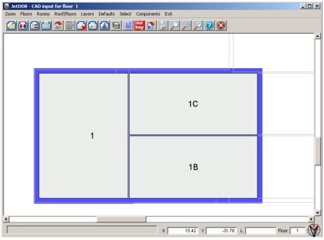

 Incorrect adjacencies
Room adjacencies will usually be created automatically, along with whether a surface is exposed or internal. If a model is inaccurately traced or the grab distance is set too large, then surfaces may not be defined correctly, as here where incorrect tracing has left adjacencies to room 1 , 1b and 1c incorrect.
The correct room layout could be easily created by considering grab distance and by using care when tracing.

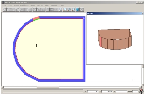

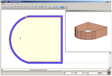

 Rounded surfaces

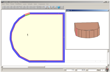

Design Database doesn't intrinsically support spherical surfaces. They can be modeled reasonably accurately by incorporating a series of straight wall sections:
You should be aware however that a large number of surfaces would have an adverse effect on the time taken to run Design Simulation projects. It may also introduce more surfaces than the SBEM calculation engine (PartL) can handle. We recommend using as few surfaces as possible model the curved wall, without drastically affecting the room floor area:
