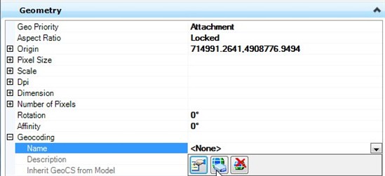

The Geographic Coordinate System (GCS) settings for images can be edited in the element information dialog for the image element.  The settings are in the Geometry section under Geocoding.  The settings are: Name, Description, and Inherit GeoCS from Model.  Name and Description relate to those in MicroStation’s GCS library.  By clicking to the right of the Name (to assign a value) three tools are available.  The first is to display the properties of the GCS of the image, the second to assign a GCS to the image from the library, and the third to delete the GCS of the image.  Inherit GeoCS from Model refers to the model the image is attached to and can be set to inherited or not inherited.  i.e. The image can get its GCS from the model it is attached to or not.

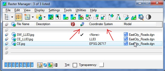

The settings can be viewed in Raster Manager by displaying the columns Inherit GeoCS from Model and Coordinate System.  In addition the GCS can be assigned or deleted by right clicking on an image in Raster Manager and from the menu, select Coordinate System > Select from Library… or Delete.
In the above image, only the first image, with the check mark, gets its GCS from the model it is attached to.

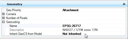

4.       In Raster Manager, Right Click on SW.jpg.  Select Coordinate System > Select from Library… or double click on the image and go to the Geometry section.
5.       Select GCS from Library and select the GCS that this image properly aligns to: EPSG:26717.
The image is re-projected “on the fly”, to align with the master file.  It is reprojected from the image GCS (EPSG:26717) to the drawing GCS (LL83).

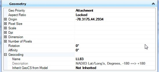

6.       Note that in Raster Manager, or from the image element information, LL83 is assigned as the GCS and the GCS is not inherited.
7.      To illustrate that the new image was reprojected to LL83 delete the GCS.  In Raster Manager, Right Click on SW_LL83.jpg.  Select Coordinate System > Delete.
Note that the image is still aligned.  Double click to open the image settings, expand the Geometry section and note that there is no GCS and Inherit GCS from Model is automatically set to inherited.
