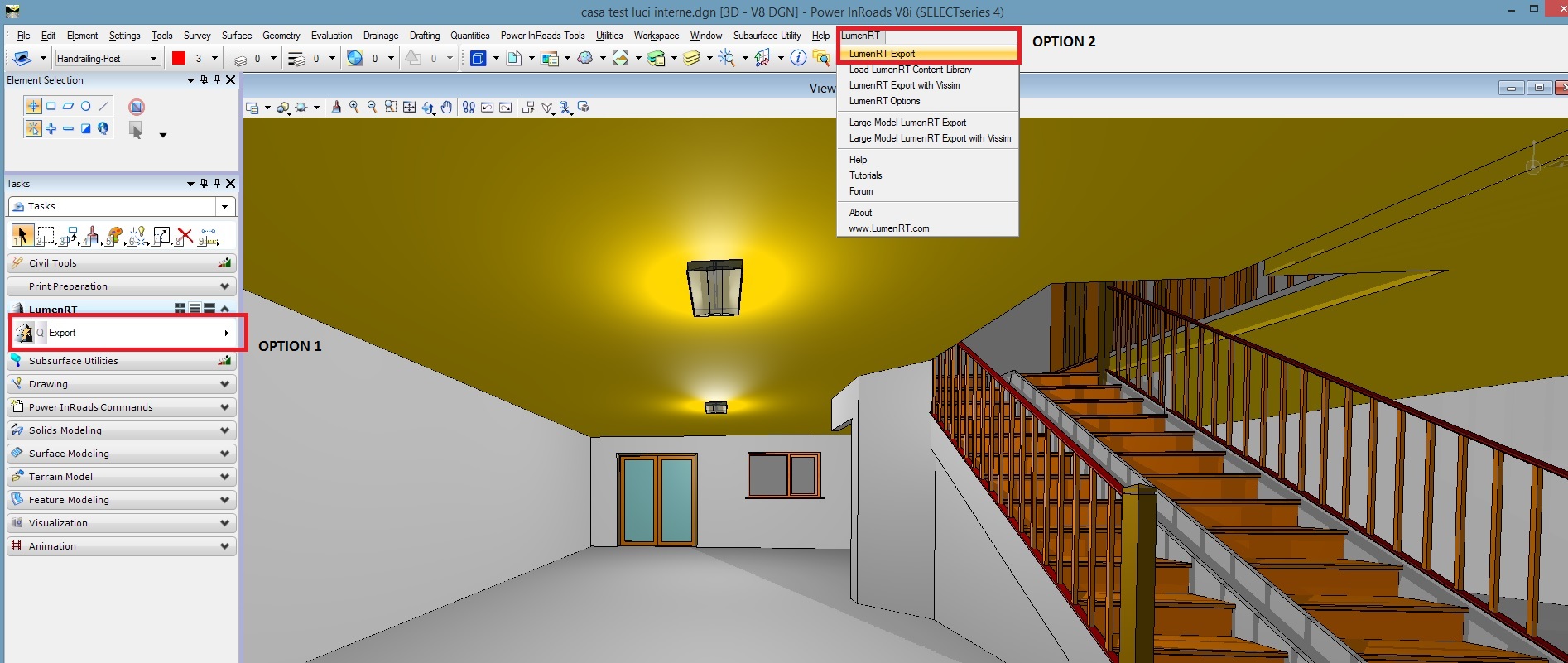

Here is described which files format is possible to open directly or not directly in LumenRT and in which way
Option 1
- If you have a *.dgn file, you can open it by all based Microstation software (e.g. Descartes, InRoads, AECOsim...)
Then you have to set a camera view and click to LumenRT Export option (2 options are available and they work in the same way):
The LumenRT software opens proptly after the export
